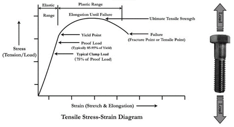

From the documentation, I understand:
The strength of the thread is determined by the stress area. This stress area is the weakest point of the bolt.
Stress area = At = (phi/4)*d0^2 [mm^2]
The clamp load/preload is the same as the bolt strength. The bolt strength can be calculated with:
Fbolt = 0.75*(proof load)*(stress area) [N]
Questions:
  • What is preload (Newton) different from tightening torque (Newton Meter)? This has interfaces with each other, right?
  • Where does the 0.75 comes from in the formula of the bolt strength?
  • The bolt strength is the maximum force till where the bolt breaks? Shown in the first video at 02:17
  • The "proof load" is the peak of load (in Newton) where the bolt return to his original state? Like the yield strength?
Thanks

The clamp/load is not the same as the bolt strength. Bolt proportional limit = proof strength = (proof load)*(stress area). The equation is above is calculating 75% of the bolt proportional yield limit. When specifying a preload, oftentimes a target is 60%-90% the proof strength of the bolt.
Bolts have yield strength, proof strength, and ultimate tensile strength; yield and proof are very similar and correlate to when plastic deformation starts. Generally speaking, exceeding the ultimate strength is when something actually breaks.
Proportional limit is when the elasticity of the bolt begins to deviate from a linear Hookean relationship (stress = E*e). This occurs just before the actual elastic limit is reached. Loading a bolt to the proof strength and unloading would be purely elastic. However, the proportional limit is often measured and reported with an offset. You should look further into that to understand it better.

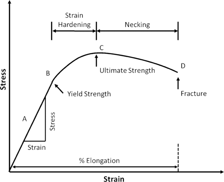

Is like a stress-strain curve? Whereby the proof strength is between yield strength and ultimate strength below?
Proof strength is slightly below yield, otherwise loading to proof and unloading would not be purely elastic. It correlates to the proportional limit.

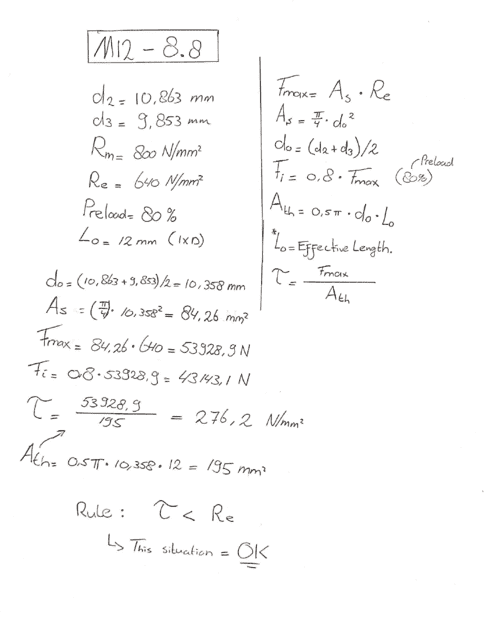

Thanks @Lnewqban .
I think I do understand it (in slow steps) a bit better now. I did the following calculation:
Conclusion of this calculation is a bolt (M12 in this case) with an effective length of 12 mm (threaded length in counterpart), is able to handle Fmax forces of 53928 N. As well I found that if an effective length of 4 mm is chosen, T will be higher as the Re so this will make the nut (or a threaded hole) break.
Correct? :)
