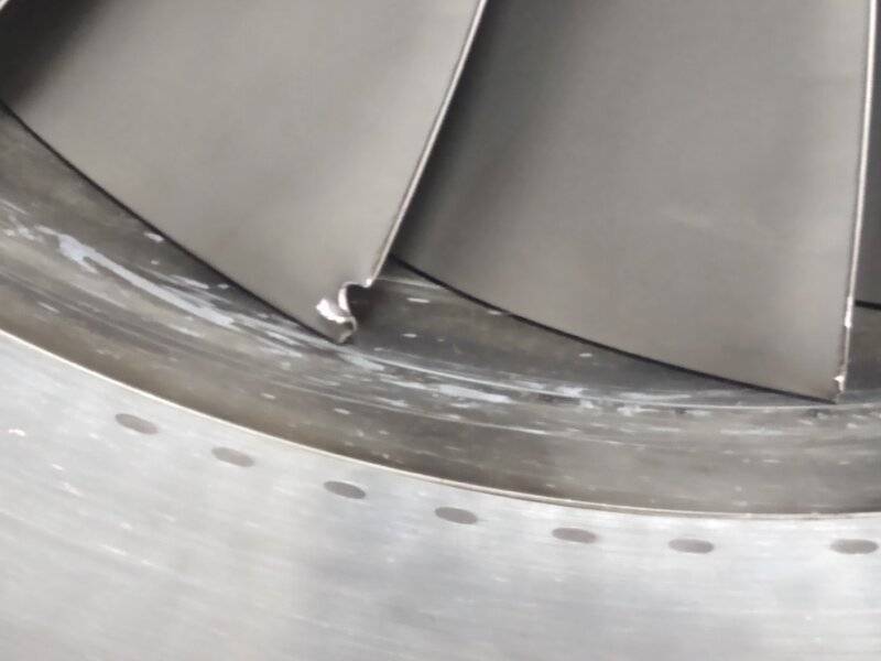

As an aircraft mechanic, I used the rule of thumb of “if in doubt, throw it out” when it came to hardware and fasteners. Replacing a screw is cheap. Replacing an engine because a worn out screw rattled loose and chewed up the fan blades is expensive.
