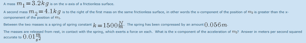

See attached
F=ma, F=kx^2
So first I looked at the forces acting on m1
m1a1=F spring on m2-F spring
Then m2
m2a2=F spring-F spring on m1
using 3rd law,
m2a2=F spring+F spring on m2
m2a2=F spring+m1a1+F spring
m2a2=2F spring+m1a1
Not entirely sure if I've done the above correctly, but I am stuck now because I have two unknowns, a1 and a2.
The answer is suppose to be 20.488 m/s^2 btw.
There is only one horizontal force that acts on ##m_2##. What is this force?
Its not force from the spring then because kx^2=4.704. Dividing by m2 gives 1.15, an incorrect acceleration.
If its the F spring on m2 then its m1a1+Fspring=m2a2, which is two unknowns still.
##kx^2## is not the correct expression for the spring force.
m2 is 'unaware' of m1. As @TSny asks, what force(s) is m2 subject to?

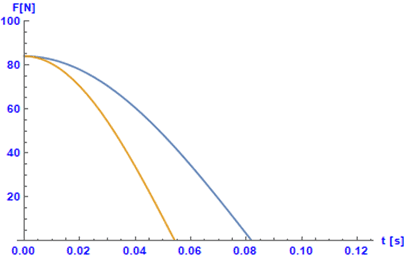

That's part of the story. Here are the graphs for the force as a function of time on ##m_2## for the two cases using the data given in the problem. The blue graph is for the case where only ##m_2## is allowed to move. The orange graph is for the case where both masses move.
You can see that the spring exerts a force on ##m_2## for about .082 seconds in the first case and only for about .054 s in the second case. Not only that, but you can also see that for any instant of time, the magnitude of the force in the first case is greater than or equal to the force in the second case.
