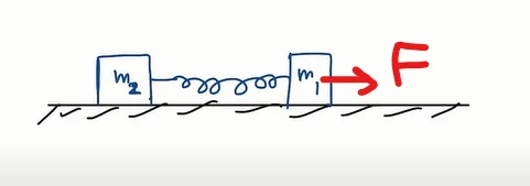

Two bars of masses m1 and m2 connected by a non-deformed light spring rest on a horizontal plane. The coefficient of friction between the bars and the surface is equal to μ. What minimum constant force has to be applied in the horizontal direction to the bar of mass m1 in order to shift the other bar?
WET, F=kx
The diagram above describes the situation. Say the spring constant is k. The main goal will be to apply the condition that when the spring force exactly balances the limiting friction, m2 will begin to slide. i.e ##kx=μm_2g##
I came up with two approaches for this one.
i) Assume that m1 is in equilibrium, so balance the spring force and frictional force with the external force.
ii)Apply WET between the two points, initial position and the final position, i.e where the velocity of m1 becomes zero.
method i) yields a solution for F which is less than ii), but the result from ii) is given as the right position. Not able to comprehend why.
Help is appreciated. Thanks.

The total force on the bar m1 is not zero, so the external force F is not in balance with the spring force and the frictional force.

Well, force balance leads to the answer: ##F= μg(m_1 +m_2)##using work done (energy balance equation) leads to ##F= μg(m_2 + 2m_1)/2##, which is given as the right answer.
So yes, you are right. Force balance is giving a solution which is more than the required force.

When ##m_1## first comes to rest, its acceleration will be maximum (not zero). So the net force on it will be maximum.

It explains why your approch in Post #7 is wrong. In Post #7 you wrote :
There is no force balance*. Forces aren't balanced because ##m_1## is accelerating.
*Edit. Let me qualify that - the forces on ##m_2## are balanced at the moment it is about to start moving.

Because to move the other block the tension has to exceed ##\mu m_2g##. If the peak tension exceeds it the block will move and if it does not the block will not move. Therefore the peak tension is what matters.

Maximum force, maximum acceleration and zero velocity is the relevant combination; the zero net force, zero acceleration and maximum velocity combination is not.

It’s essential to realise that to find the minimum value of ##F##, we must consider the case where ##m_1## gets as far right as possible (giving maximum spring extension). We need the spring tension to just reach the minimum value needed to make ##m_2## slip.
Or to say it slightly differently, ##m_1## will pass through its equilibrium position at max’ speed. It will then continue to move right but slowing down - stretching the spring more till it momentarily stops. We want the smallest value of ##F## which results in the maximum spring tension equalling the limiting frictional force on ##m_2##.
