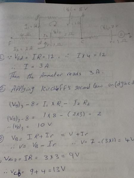

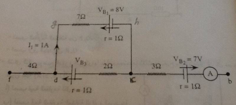

The figure represents a part of a circuit, and the potential difference between the f and d is 12Volts, depending on the information shown in the figure, determine:
1-the reading of the Ammeter
2-the value of (Vb)₃
3- the potential difference between (c , b)
Circuit schematic with points f, d, c, b, g and h: 4Ω resistor from f to d, branch d to g with I1 = 1A arrow up, 7Ω and V_B1 = 8V battery (r = 1Ω) from g to h, 2Ω resistor and V_B3 battery (r = 1Ω) from d to c, 3Ω resistor, V_B2 = 7V battery (r = 1Ω) and ammeter A from c to b.
Ohm's law: Vb=I (R+r)
Kirchhoff's law: ΣI=0
ΣV=ΣIR
Seriously, I got confused with all these batteries, and I considered that the total current is 3A, since Vfd=12.
Handwritten circuit solution: a circuit with batteries, resistors and an ammeter, followed by working for I = 3 A, Kirchhoff's second law around loop dgbcd giving (V3)3 = 10 V, and VBC = 13 V.
So, I know there may be a lot of mistakes in my solution, and I would appreciate any help or explanation of how those whole batteries would work and produce the total current.
Answers to Q1 and Q2 look good. In Q3, you are asked to find the potential difference between c and b. I think instead you have calculated Vcd (which is also not correct).
(Also, I've never seen Kirchhoff's circuit laws named as 'first law' and 'second law'. They are called Kirchhoff's voltage law (KVL) and Kirchhoff's current law (KCL).)
I made a mistake, I wrote Vcd, but I meant Vcb, I edited the photo. And in my textbook the Kirchhoff's current law can be the first law and the voltage law is named the second law.
So please, is the answer correct now?

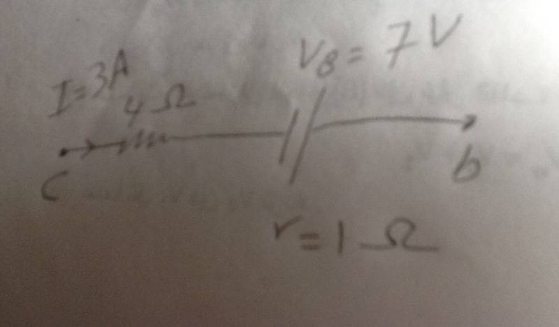

No.
Just redraw the circuit from c to b.
Draw a 4 ohm resistor (3 ohm + 1 ohm) in series with the battery of 7V emf. Note the polarity of the battery. A current of 3A is flowing through the c-b branch from c to b. So, when going from c to b
i) What is the potential change across the 4 ohm resistor? Is it a gain or a drop?
ii) What is the potential change across the battery? Is it a gain or a drop?
Add the answers of i) and ii) and you'll get Vcb.

Ok,
Handwritten circuit segment: current I = 3 A flows right through a 4 Ω resistor from point c to a battery of emf 7 V with internal resistance r = 1 Ω, ending at point b.
i) V= IR=4*3=12V (a drop)
ii) V= Vb-Ir=7-3=4 ( a gain because the current of the battery is going out from the positive to the negative) I use the conventional direction.
So 12+4=16V
Or what did you mean by the potential change across the battery?
Right.
No. The internal resistance is taken care of already in i). So in ii), you must consider the emf of the battery, which is 7V.
You are right about the potential gains and drops in i) and ii).
So, what is Vcb now?

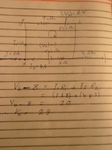

Oh yes! That will change things:( Vb)3 would be 28V, and the ammeter still reads 3A, and the potential difference between c and b would be 19V ( as I understand it because I have a problem with Q3) are these answers correct?
Yes, that looks good.
Handwritten circuit diagram on lined paper with a loop of resistors labelled 7 ohm, 1 ohm and 2 ohm, a 3 ohm resistor, a battery labelled V_b1 = 8 V, a voltage marked V_0 = ?, and currents I_1 = 1 A, I_2 = 4 A and I = 3 A, followed by the handwritten working V_b - 8 = I_1R_1 + I_2R_2 = (1 x 3) + (4 x 3) = 20 and V_0 = 28.
Is this correct, cnh1995!
Handwritten circuit diagram on lined paper with a loop containing 7 ohm and 2 ohm resistors, internal resistances r = 1 ohm, a 3 ohm resistor, currents I1 = 1A and I2 = 4A, a 3A current, and V0 = ? with Vb = 8 V; below it is the working V0 - 8 = I1R1 + I2R2 = (1 x 3) + (4 x 3) = 12, giving V0 = 20.
Yes. Good job!

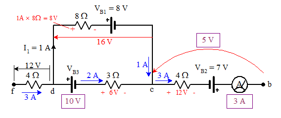

Since the OP has correctly solved the problem (both cases) I 'll present a summary of the work in the form of two annotated circuit diagrams. In both diagrams the battery internal resistances have been lumped together with the external resistors.
Case 1: the given PD causes current to flow from f to d:

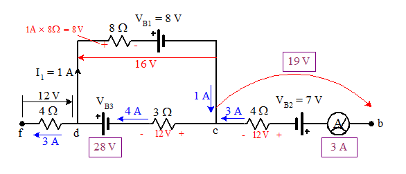

Case 2: the given PD casues current to flow from d to f:
Annotated circuit diagram with batteries VB1 = 8 V, VB2 = 7 V and VB3 = 28 V, resistors of 8 Ω, 3 Ω and 4 Ω, and currents of 1 A, 3 A and 4 A marked, with voltage labels including 16 V, 19 V and 12 V.
