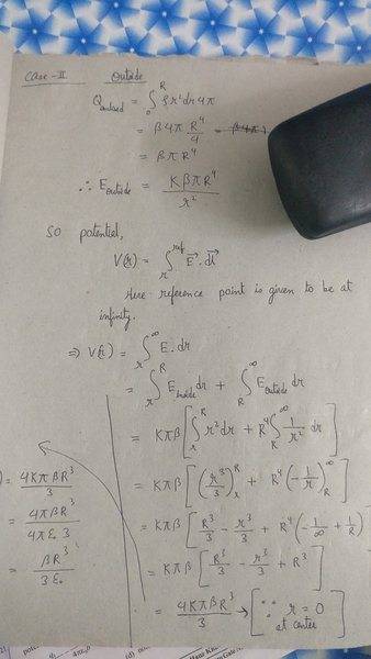

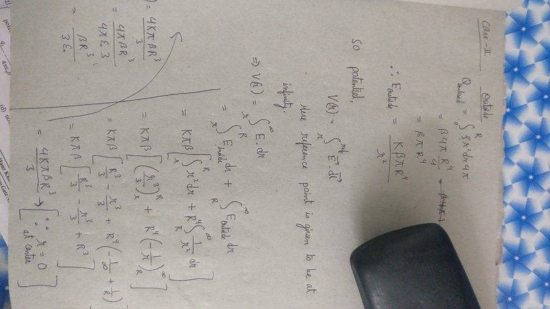

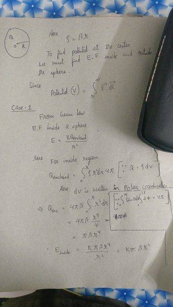

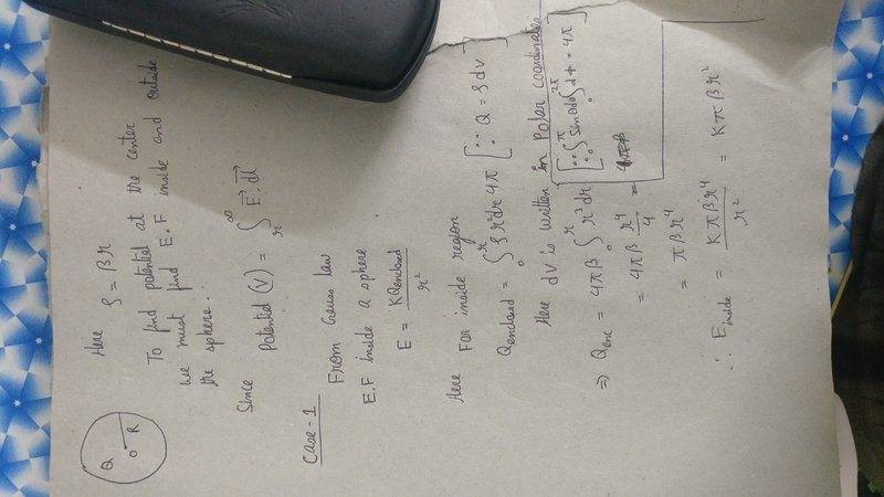

Neolight
A sphere of radius R has a volume charge density proportional to distance from center. Total charge contained in the sphere is Q. If electric potential at infinity is taken to be zero , potential at it's center is
Here given are
ρ= βr where β is a constant
Since in this question the charger density is not uniform so I attempted the question by first finding out the electric field on the inside and outside region by using Gauss law than.
Please give me some hints on what I have done wrong because the answer is
V= Q/3Πξ.R
And I also think that somehow we have to find the value of β
And one final personal question
Is this question a difficult level question because I have spent like 2 hours in a day for 4 days and haven't been able to answer due to mistakes here and there and lately because of this I have started losing confidence in myself because I can't even solve this question.

I don't want to read your sideways picture, but ## Q=\int\limits_{0}^{R} \beta r \, 4 \pi r^2 dr ##. That will allow you to find ## \beta ##. You then need to find ## E(r) ##, (by Gauss' law), as a function of ## r ## both inside and outside the sphere. That will allow you to compute ## V(r)=-\int\limits_{+\infty}^{r} E(r') \, dr' ##. ## \\ ## Maybe I'm a little fussy, but I think it is asking a lot to have someone need to turn their computer sideways to try and read a sideways picture.

Here are my calculations

It looks quite accurate. The equation ## \beta \pi R^4=Q ## applies, so that ## \beta=Q/( \pi R^4) ##. You basically computed this, but didn't include it. You can substitute this for ## \beta ## in your final answer. From what I can tell it looks right=I didn't see any mistakes.

Looks like the OP got the right answer, which is ## V=\frac{Q}{3 \pi \epsilon_o R} ##. And the OP should use an ## \epsilon_o ## (epsilon), rather than a ## \xi_o ## (xi).
