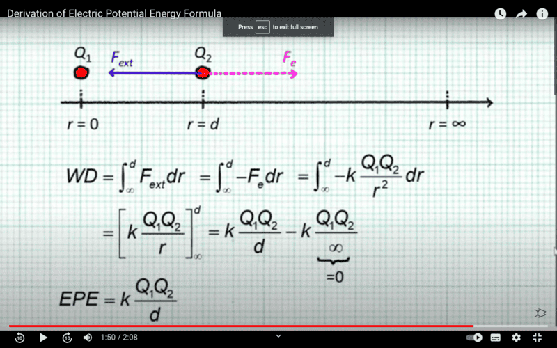

I have several questions relating to electrostatics:
first of all, in this derivation for the formula of the electric potential energy:
work is being done against the electric field right, so the work should be negative, but in this case it's positive. I'm wondering if it's because the direction of dr and the force should be in the same direction so when you take the dot product it's a positive result? Then the work done will be negative and according to the equation W=-delta U then U will be equal to positive kq1q2/r?
No, if work is done in opposing the field then the work done is positive. Think about lifting a weight.
Consider the case where ##Q_1## and ##Q_2## are both positive. A leftwards external force (##\vec F_{ext}##) is applied to ##Q_2##, moving it leftwards towards ##Q_1##. ##\vec F_{ext}## and its displacement are in the same direction (both to the left, both negative) and their dot product is therefore positive. The work done by ##\vec F_{ext}## is positive.
Energy has been supplied by ##\vec F_{ext}## and this has increased the system’s potential energy,
(Note that the work done done by the electric force, ##\vec F_E##, is negative. This work is minus the charge in potential energy. This is may be easiest to understand by considering gravity. If you drop a stone, gravity does positive work (providing kinetic energy); as a consequence, the change in gravitational potential energy is negative.)
This is my answer to your "First of all question" which is a recurring issue when on applies the definition of work ##dW=F~dr~\cos\!\theta## and then tries to do an integral with lower and upper limits. The remedy is to ignore the relative direction between force and displacement and the sign of the charge and do it formally using the definition of work done by a force as a line integral. For this example,
1. Start with ##~W_{AB}=\int_A^B \vec F \cdot d\vec r.##
2. Use unit vector notation to express the vectors
##~\vec E=\dfrac{kQ_1}{r^2}\mathbf{\hat r}~;~~\vec F=Q_2\vec E=\dfrac{kQ_1Q_2}{r^2}\mathbf{\hat r}.##
##d\vec{r}=dr~\mathbf{\hat r}.##
3. Find an expression for the integrand
##\vec F \cdot d\vec r=\left(\dfrac{kQ_1Q_2}{r^2}\mathbf{\hat r}\right)\cdot(dr~\mathbf{\hat r})=\dfrac{kQ_1Q_2}{r^2}dr.##
4. Integrate $$W_{AB}=kQ_1Q_2\int_{r_{\!A}}^{r_{\!B}} \frac{dr}{r^2}=-kQ_1Q_2\left(\frac{1}{r_{\!B}}-\frac{1}{r_{\!A}}\right)
.$$Note that with this formal method all negative signs are taken care of automatically and you don't have to worry about the relative orientation of vectors.
  • If either one of the charges is negative, the work changes sign.
  • If, instead of going from ##r_{\!A}=d## to ##r_{\!B}=\infty##, you reverse path and go from ##r_{\!B}=\infty## to ##r_{\!A}=d##, the work changes sign. The element ##d\vec{r}## is always and by definition equal to ##~(+dr~\mathbf{\hat r}).##
  • Double changes of sign, e.g. reverse the path and change the sign of one charge, do not change the sign of the work.
In short, let the unit vectors do the work for you (the pun is intentional.)

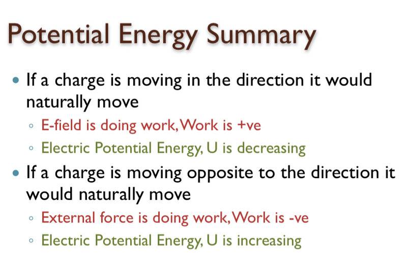

Oh really, the slides my professor gave me said doing work against the field is negative..
That slide is quite misleading. It doesn't specify which work is being considered as positive or negative, the work done by the field or the work done by the external force.
Better would be:
  • If a charge is moving in the direction it would naturally move, the E field is doing positive work
  • If a charge is moving opposite to the direction it would naturally move, the E field is doing negative work
There might or might not be an external force. If the speed is constant there must be one and we can add:
  • If a charge is moving in the direction it would naturally move, the external force is doing negative work
  • If a charge is moving opposite to the direction it would naturally move, the external force is doing positive work
Or if no other force is present then the speed must be changing and the charge must have mass:
  • If a charged mass is moving in the direction it would naturally move, with no other forces present, the E field is doing positive work accelerating the mass
  • If a charged mass is moving opposite to the direction it would naturally move, with no other forces present, the E field is doing negative work, slowing the mass

Ohh ok, yeah this is much clearer. Thanks. But why would a charge just move in the opposite direction it will naturally move without an external force?
It would not do so from rest, but some force could have sent it that way then ceased to act, leaving it to continue under its own momentum. The charged mass slows as it does positive work against the field.

Oh ok, I understand. So then work done by E field = -Work done by charge?
I would phrase it somewhat differently. The charge is the system and work is done on it by external forces. Prepositions are important and the system (charge) cannot do work on itself.
If the charge moves at constant velocity in an electric field then the net force on it is zero. The work done by the electric field on the charge is the negative of the work done by the external agent on the charge. This is the case regardless of whether the charge is moving in the same or in the opposite direction as the field.
Say the charge would "naturally move" to the right if the electric field were the only force acting on it. This means that the electric field does positive work on the charge if it is moving to the right and negative work if it is moving to the left.
Imagine the charge being held by a hand and moving to the right at constant velocity. "Naturally", the charge would accelerate to the right but the acceleration is zero. The electric field does positive work and the hand does negative work on the charge so that the net work is zero. The electric field acts as if it were an accelerator while the hand acts as if it were a brake.
Now imagine the charge being held by the hand and moving to the left at constant velocity. "Naturally", the charge would accelerate to the right but the acceleration is zero. The electric field does negative work and the hand does positive work on the charge so that the net work is zero. The hand acts as if it were an accelerator while the electric field acts as if it were a brake.
The symmetry in exchanging the roles that the external forces play is guaranteed by Newton's third law.

kuruman said:
The net charge is not zero. The net work is zero. That's because the charge is moving with constant velocity by assumption. According to the work-energy theorem the change in kinetic energy of the charge is equal to the total work done on the charge. If the kinetic energy does not change, this total work is zero.
Where did you get this idea? The charge is indeed moving at constant velocity. Please reread post #12.
Sorry yeah I was meant to type work, I understand now! Thanks a lot.
