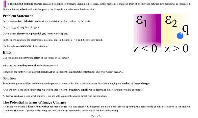

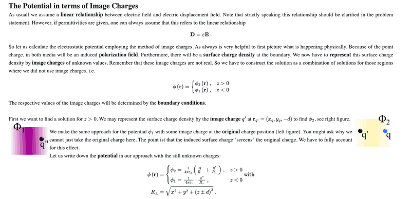

Why in this problem when solving for the electric potential in the z<0 region we introduce another image charge that is the same as the original charge instead of just using the original charge? I don't really get the explanation they provide.

When finding the potential ##\phi_1## in region z<0, the image charge is not the same as the original charge. The image charge has the same location as the original charge, but the charge of the image is ##q''##, which differs from the original charge ##q##. The value of ##q''## will be determined in the analysis.
Also, when writing the potential ##\phi_1##, we imagine that the purple dielectric ##\varepsilon_1## extends throughout all of space: both z < 0 and z > 0. Thus, although ##q''## is located in the region ##z > 0##, ##q''## is taken to be immersed in dielectric material with ##\varepsilon_1##.
That's why you see this figure
Likewise, in writing the potential for ##\phi_2##, the yellow dielectric ##\varepsilon_2## is assumed to extend throughout all of space.
