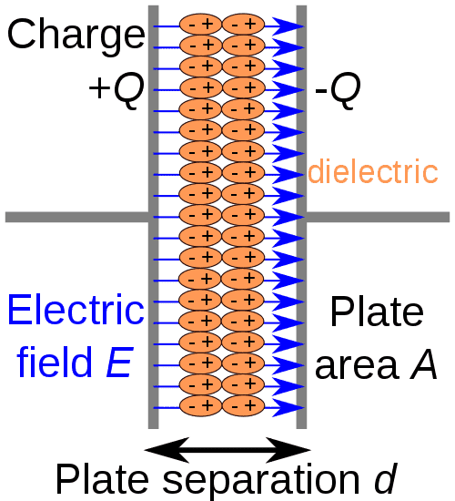

Hello!
Electric force is inversely proportional to the dielectric constant. In a textbook, this is said to be forty-fold greater for water than the phospholipid membrane. As such, ions are unlikely to cross the plasmamembrane. I assume this has something to do with preferring to stay in water. Here's the thing, this is force, and not energy. Okay, the two are related (from my limited understanding), but not the same. Why would a reduced force between ions lead to the inability of ions to cross the membrane? If the dielectric constant is lower in the plasmamembrane, then the force is greater between ions. I am guessing an increased force means that like charges trying to accumulate to interact ith opposite charges will be unstable? Or something...
There's something obvious I'm missing here.
Maybe its that to separate charges to partition the ion into the membrane would require more energy than is available?
Any help appreciated.

The force that is being talked about is the force between the two oppositely charged plates of a capacitor. If the intervening medium has a large dielectric constant, it is highly polarizable, and the induced polarization can partially "cancel" the local charge on the capacitor plates. Since the local charge is effectively reduced, the effective field and force between the capacitor plates is also reduced. The link in post #3 explains this in more detail.
So the relationship between the dielectric constant and force reduction between capacitor plates and low ionic solubility are both explained by the idea that the dielectric constant is related to a material's polarizability.

No, the force is not inside the membrane. Like atyy said, it is the force between the two plates of a charged capacitor. The two sides of a plasma membrane can act like the two plates of a capacitor.
What happens when we insert a dielectric between the plates is something like this.
The polarization of the dielectric generates an opposing electric field causes the net field to be less than what it would have been, had it not been there at all. The dielectric constant can be in fact expressed as the ratio of the field before to the field after inserting the dielectric.
