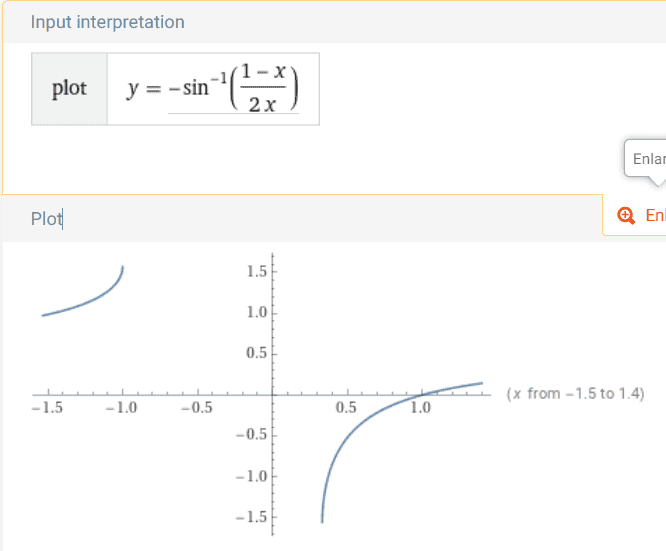

Thanks. I let wolfram draw the graphs.
https://www.wolframalpha.com/input?i=plot+y=-+arcsin+(+(1-x)/(2x))
Wolfram Alpha plot of y = -sin^-1((1 - x)/(2x)) for x from -1.5 to 1.4, showing two separate branches: one rising on the left from about -1.5 to -1, and one rising steeply from near 0.33 to about 1.0 on the right, crossing the x-axis near 1.

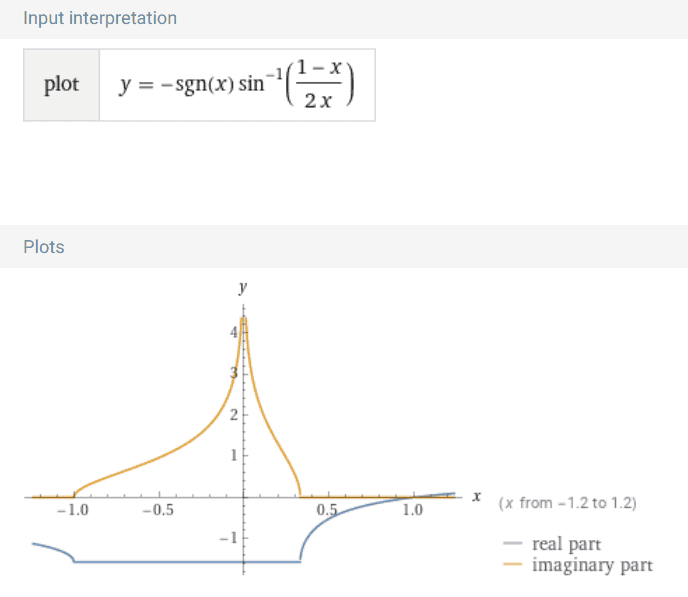

The right answer for x<0 needs -1 to be multiplied.
https://www.wolframalpha.com/input?i=plot+y=-+sgn(x)+arcsin+(+(1-x)/(2x))
Wolfram Alpha output for plot of y = -sgn(x) arcsin((1-x)/(2x)), showing real part (blue) and imaginary part (orange) over x from -1.2 to 1.2; imaginary part peaks near x = 0 at about 4.
So for x<-1
[tex]\int_x^{-1} \frac{dt}{t\sqrt{3t^2+2t-1}}=-\sin^{-1}\frac{1-x}{2x}-\frac{\pi}{2}[/tex]
for 1/3 <x
[tex]\int_{1/3}^x \frac{dt}{t\sqrt{3t^2+2t-1}}=-\sin^{-1}\frac{1-x}{2x}+\frac{\pi}{2}[/tex]

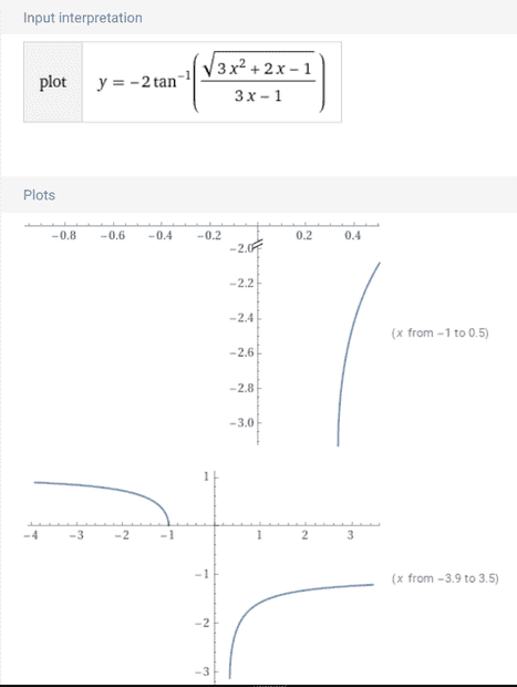

https://www.wolframalpha.com/input?i=plot+y=-2+arctan+(+\sqrt(3x^2+2x-1)/(3x-1))
So for x<-1
[tex]\int_x^{-1} \frac{dt}{t\sqrt{3t^2+2t-1}}=2\tan^{-1}\frac{\sqrt{3x^2+2x-1}}{3x-1}[/tex]
for 1/3 <x
[tex]\int_{1/3}^x \frac{dt}{t\sqrt{3t^2+2t-1}}=-2\tan^{-1}\frac{\sqrt{3x^2+2x-1}}{3x-1}+\pi[/tex]

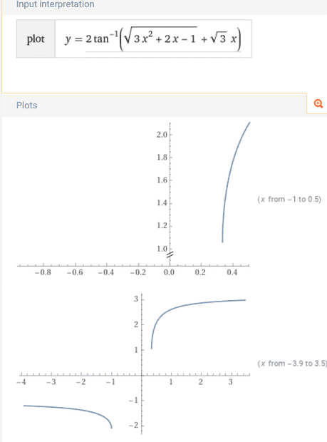

https://www.wolframalpha.com/input?i=plot+y=2+arctan+(+\sqrt(3x^2+2x-1)+\sqrt(3)x+)
So for x<-1
[tex]\int_x^{-1} \frac{dt}{t\sqrt{3t^2+2t-1}}=-2\tan^{-1}(\sqrt{3x^2+2x-1}+\sqrt{3}x)-\frac{2\pi}{3}[/tex]
for 1/3 <x
[tex]\int_{1/3}^x \frac{dt}{t\sqrt{3t^2+2t-1}}=2\tan^{-1}(\sqrt{3x^2+2x-1}+\sqrt{3}x)-\frac{\pi}{3}[/tex]
