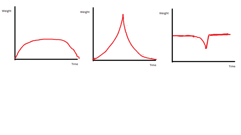

Draw graphs of weight against time for the following
1) man stands on scale very gently and then gets off again very gently
2) man jumps onto scales and then jumps off again
3) man stands on scale and let's his knees unlock so that he drops, then stops.
For each of these describe the reasoning behind the graph.
mg = R
Resultant force causes an acceleration F=ma
1)A slow acceleration possibly constant velocity of approach means the change in weight over time is small and the maximum weight is equal to the weight of the man
2)The man is originally accelerating downwards therefore the reaction force provided by the scales must increase therefore a simulated increase in weight. Vice-versa for jumping upwards
3)Weight must decrease before returning to original weight
My attempts at the graphs are attached going 1 -> 3, left to right. I'm not sure about 2 and 3 as I think I contradict myself
Thanks for the help

Have another think about 2 and 3.
2) If you jump in the air and land on the scales you will hit the scales with some velocity. Some time later that velocity has gone and you are just left standing on the scales. What will the scales read during the impact phase? Same/higher/lower than your weight? What will the scales read when you have come to rest and are just standing on them (lets say you stand on them for 5 seconds before jumping off).
3) You have this partly right. The weight will reduce while you are dropping but what happens after that? See Q2.
For number 2, should the weight actually decrease then because the man is accelerating downwards (during the impact stage). When you are at rest, then your weight should be correct as you are stationary.
For number 3, I can't see why the weight of the man should not return to normal after he becomes stationary again. The only change I can think of is that the man's centre of gravity has now changed but I cannot see how this affects the reading

Just after landing on the scales, he's moving downwards, but which way is he accelerating?
Remember that what the scales actually read is how far the spring is depressed. There is a certain depression which corresponds to his rest weight. When the scales are lower than that he will show as weighing more, when above that, less.

No it won't be less during the impact phase. Think about the difference between placing a weight on your foot and dropping a weight on your foot :-) Which is going to hurt more?

It does, but as you said that's "after he becomes stationary again". What happens between him being in free fall/weightless and him becoming stationary again?
For Number 2
The weight of the man would increase as he hits the scales but then as he becomes stationary the spring becomes less depressed and therefore shows a smaller weight (F=-kx). I'm unclear as to whether the weight shown should actually decrease for a while because there needs to be a resultant force upwards in order to decelerate the man.
When he jumps off, the reading should first increase(?) because he applies more force downwards in order to jump off. When he starts to accelerate upwards, the reading should decrease because there is less force acting on the scale

Would the reading slightly increase because there needs to be a resultant force upwards in order to decelerate the man so he becomes stationary

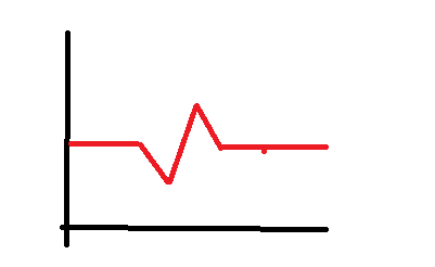

From what I can tell for number three is that when I am stationary my weight is constant. When I unlock my knees the reading decreases from equilibrum and then increases when I start to stop and slow down before returning the original weight which makes sense having now discussed it. It looks a bit like image wt2.
For number 2, I can only try what happens when I am stationary and I am preparing myself to jump as when I jump on my scales it just crashes. The graph seems to look like wt3 which is essentially wt2 but a bit extra when I start to jump as I increase the force because I push downwards and then as the contact reduces the weight reduces. I just can't imagine what would happen before I am stationary and I am jumping onto the scales
In the pictures I have draw the changes linearly when they should be curved

I man the system, spring+man. Springs imply oscillation.
I think the first thing you would do is then decelerate downwards,
accelerate downwards
meaning a reduction in the reading on the weight before you then start the motion of jumping upwards
When he is accelerating downwards, the reading should be lower than his normal weight
Yes.
