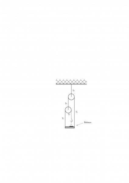

wah31
Man standing on scale and pulling on a rope connected to two pulleys
The mass of the man is: m=100 kg
The weight of the pulleys, cables, balance, and the frictions are not taken into account
g=10m x s-2
3. The Attempt at a Solution
the force that the man should draw in order to maitain balance:
T1=250 N
The weight displayed on the scale:
P= 125 kg
Other tensions:
T2=250 N
T3=500 N
T4=500 N
T5=1000 N
Do your agree with that ?
Thank you..

I agree with all the tensions, but I do not understand how you got 125kg for the scale reading. Consider again which way the forces act on the man.
I'm not convinced either
I thought about it..
Yes I agree there is something wrong
What do we know for sure ? ...T1= T2 and T3 =T4 ... 4xT1 = 2xT4 = T5 and T5 is supporting all the mass = 100kg = 1000N ... so all the tensions are correct .
The weight indicated on the scale must be the man's weight , minus the the pull from T1 ... 1000 - 250 = 750N scale should indicate 75Kg not 125kg
Yes you are right :check:
Thank you.. it's cool :oldbiggrin:
