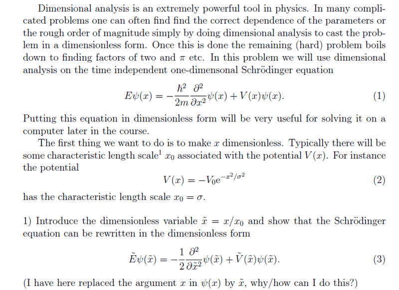

I have an exercise at the moment where I am supposed to put the Schrödingerin dimensionless form (the exact exercise is attached). I must admit that this idea of dimensional analysis is quite new to me. I don't understand how you can write the SED in the dimensionless form described. Therefore I could use some hints from one of you :) They introduce this new x' = x/x0. To put the SED in the given form are we then supposed to substitute x = x'x0 in the SED? If so I don't see how the h^2/2m disappears.

The second derivative also changes:
[tex] \frac{\partial^2}{\partial x^2} \stackrel{?}{=} k \, \frac{\partial^2}{\partial x'^2}[/tex]
How is k related to x0?
I guess the derivative somehow would throw a factor of 1/x02 in but I am overall unsure about what is done in this exercise.
Do we switch variables from: x-> x'/x0? In that case everything that is named x should just be changed to x' and I can't see what sense that would make. On the other hand we could subsitute x= x'x0 but I don't see that going anywhere. Can you in detail explain what the idea is?
I'm not here to do your homework. You are right that you get a factor of [itex]1/x^2_0[/itex] in front of the second derivative. Now, if you multiply by
[tex] \frac{m x^2_0}{\hbar^2}[/tex]
the coefficient in front of the second derivative becomes [itex]-1/2[/itex], as required in the problem. You can read off what [itex]\tilde{V}_0[/itex] and [itex]\tilde{E}[/itex].

Do we switch variables from x-> x'? In that way I don't see how the factor of 1/x02 comes in since you would basically just replace every x by x'? You could I suppose plug in x = x'x0 but that doesn't seem to make sense either. Can't you see the problem? A student pointed out the problem today too and the teacher agreed in a way and said something I didn't really get.
