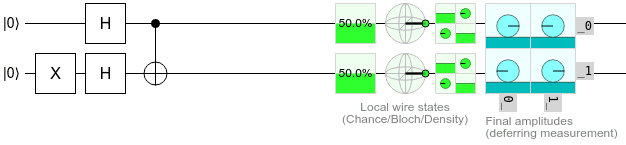

We can confirm this by simulating in Quirk:
Quantum circuit diagram with two qubits starting in |0>: qubit one passes through an H gate, qubit two through an X gate then an H gate, followed by a controlled-NOT gate; output probability bars and amplitude plots are shown on the right.
The output display shows a positive (rightward) amplitude for 00 and 11, and negative amplitude for 01 and 10. Just like we calculated. (The magnitudes also agree.)
