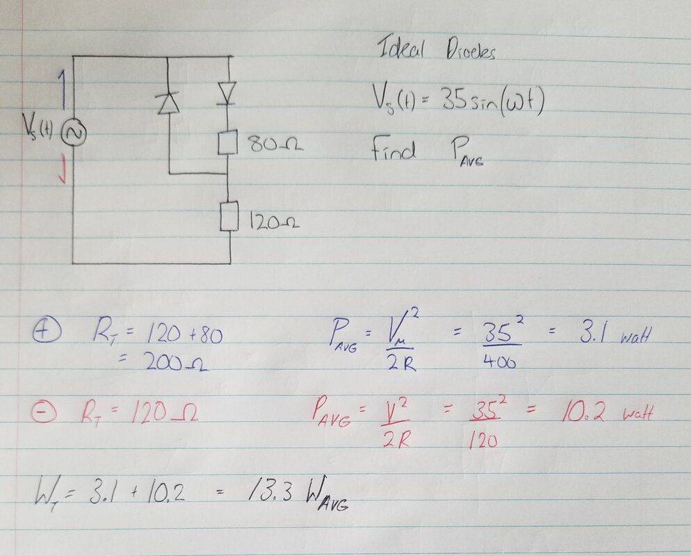

Hello all,
I've just started learning about diodes.. I believe I've done this problem correctly (question in black), although want to make certain I'm understanding the very basics before moving on. Thank you
The applied voltage has a peak amplitude of ±35 volt.
You should be using the RMS voltage, for half the time.
So why did you use a factor of ½ in; P = V² / 2·R

You have found the average power during each half-cycle correctly.
However, adding the two powers is wrong. I’ll make up a simple example for illustration:
Frequency = 1Hz (So each half-cycle takes 0.5s)
Average power during 1st half of cycle = 8W
Average power during 2nd half of cycle = 20W
Energy/cycle = 8*0.5 + 20*0.5 = 14J
Average power during complete cycle = ##\frac {14J}{1s} = 14W## (not 28W).

$$P_{avg} = \frac {V_{peak}^2}{2R}$$
is fine because the average power is half the peak power.
This will be clear if you apply ##V_{peak} = {V_{rms} √2}##

You cannot be sure if the factor of ½ employed by the student was for the RMS conversion, or for the 50% duty cycle conversion. For that reason we should not do the students homework, but should ask the student to explain their derivation of their equation. @WRS got it half correct.
I see what you mean. Since the OP had written$$P_{AVG} = \frac {V_M^2}{2R}$$I assumed ##V_M## was intended to be the maximum (peak) voltage, so thie formula simply appeared to be a statement of a ‘standard’ result.
However, I agree that it is quite possible that the OP had misunderstood. It would have been better to let him clarify this.
