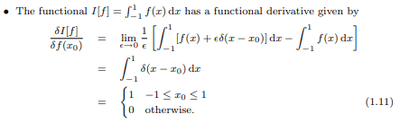

Which is correct:
$$\int_{-1}^1 \delta (x-x_0) \, dx =\begin{cases} 1, -1\leq x_0 \leq 1 \\ 0, \text { otherwise} \end{cases}$$
or
$$\int_{-1}^1 \delta (x-x_0) \, dx =\begin{cases} 1, -1< x_0 < 1 \\ 0, \text { otherwise} \end{cases}$$
Sorry, not so sure, again. Because, e.g., $$\int_{-1}^2 \delta (x-1) \, dx = 1$$ but if the first case above is correct, then $$\int_{-1}^2 \delta (x-1) \, dx = \int_{-1}^1 \delta (x-1) \, dx +\int_1^2 \delta (x-1) \, dx =2$$ and if the second case is correct, then $$\int_{-1}^2 \delta (x-1) \, dx = \int_{-1}^1 \delta (x-1) \, dx +\int_1^2 \delta (x-1) \, dx =0$$ So, how does it work?
By symmetry, we must have:
$$\int_0^1 \delta(x) dx = \frac 1 2$$I use a rule of thumb that what holds for ##\delta (x)## must hold for the limit of appropriate Gaussians.
I see. Then you disagree with the following example from the QFTftGA:
By your definition, it should rather be $$...=\begin{cases} 1, -1< x_0 < 1 \\ \frac 1 2, x_0=-1\\ \frac 1 2, x_0=1\\ 0, \text { otherwise} \end{cases}$$ Is it so?
I'd say so. I can check my notes, but it seems a minor detail. I told you the maths was wild and woolly.
