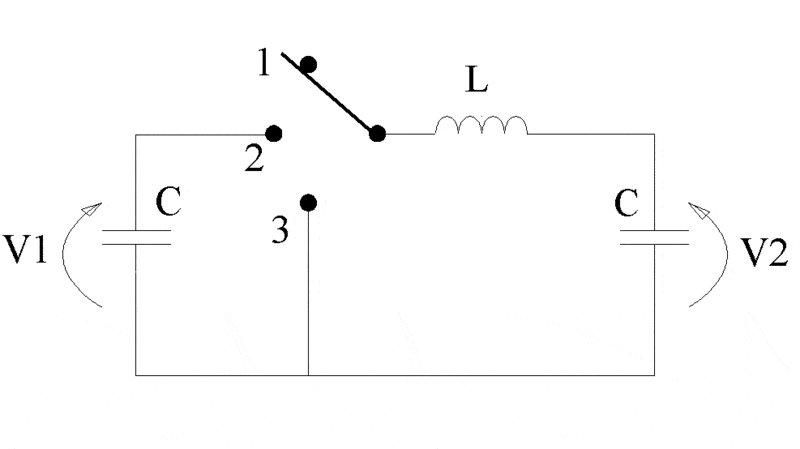

Thank you for your help guys, but just to clarify, is it possible to use a transformer to take a 10,000uf cap charged to 12v to end up with two caps rated at 10,000uf charged to 7 or even 8v each.
Or to put it simply. Is it possible to end up with more coulombs then what you started with?
Bear in mind the transformer works on AC voltage, not DC. So the charge on the capacitors will be oscillating all the time. I'm not sure if your question makes sense here. You'll then have to calculate the RMS value of the energy stored in the capacitors.

Well, you couldn't do it through a resistor, as I showed above, because you lose energy to the resistor. Perhaps you could do it with some fancier circuit using inductors, but I don't know.
Assuming no energy loss you would have each capacitor charged to 1/sqrt(2) of the original voltage. So if you started with each at 10 V you could end with each at a maximum 7.07 V from energy conservation considerations alone.
Note that you are not "creating charge", there is no conservation of matter concern here. All you are doing is separating more charges.
Oh well, looks like I lost that bet :smile: though if the half the energy is lost in charging a capacitor from another capacitor as heat (even in the theoretical scenario of zero resistance) how can an inductor prevent or reduce this loss since an inductor will probably have higher resistance than simply connecting the caps together and will probably emit more energy as EM? I am not asking for a circuit, I am just trying to understand.
The reason that the same amount of energy is dissipated in the resistor regardless of the resistance is that as the resistance goes to zero the current goes to infinity. An inductor prevents that runaway current. Also, an inductor is an energy-storage component, so the energy that goes into the inductor will come back out.
I don't know that it would work, I would have to solve the equations to see, but it is different than just using a resistor.

You can use a diode to automatically stop the current when the second capacitor reaches it's maximum value (at which point 100% of the energy in the first capacitor is transferred to the second one). If however you want to get some other final voltage on each capacitor then you do need to do some active switching.
With reference to the circuit in the attached figure let me outline its operation (assuming we desire to get half the initial energy on each capacitor).
Initial conditions: Assume v1(0)=V, v2(0)=0 and the inductor current is i(0)=0. I'll also assume that the two capacitors are of equal value.
- Assume the switch is in position one for t<0 and we switch it to position 2 at t=0.
Solving the DE's with the above IC's gives :
i = \frac{V}{\omega_1 L} \sin(\omega_1 t)
v1 = \frac{V}{2} ( 1 + \cos(\omega_1 t) )
v2 = \frac{V}{2} ( 1 - \cos(\omega_1 t) )
where \omega_1 = \sqrt{\frac{2}{LC}}
- Switch to position 3 at \cos(w_1 t) = \sqrt{2} -1[/tex] (and therefore \sin(w_1 t) = \sqrt{ 2 \sqrt{2} - 2 } ).<br /> <br /> At this point v1(t) remains constant at V/ \sqrt{2}, so it retains half of it&#039;s initial energy.<br /> <br /> (For convenience I&#039;ll reset the time variable to zero for the next phase of the analysis).<br /> <br /> The initial conditions for the next transient are therefore i(0)=\frac{V}{w_1 L} \sqrt{2 \sqrt{2} - 2}<br /> and v2(0)=V*( 1 - 1 / \sqrt{2} )<br /> <br /> Now V2 = A cos(w_2 t) + B sin(w_2 t)<br /> <br /> where w_2 = 1/ \sqrt{LC}, A = v2(0) and B = i(0)/(w_2 C)<br /> { B = V* sqrt(2 sqrt2 - 2)/(w1 w2 LC) = v* sqrt(sqrt2 - 1) }<br /> <br /> So v2 = V \, (1-1/ \sqrt{2}) \, \cos(w_2 t) + V \, \sqrt{\sqrt{2} - 1} \, \sin(w_2 t)<br /> <br /> The maximum voltage reached on capacitor C2 is v_2 \max = \sqrt{A^2 + B^2}<br /> <br /> So v_2 \max = V \sqrt{\sqrt{2} - 1 + 1 + 1/2 -\sqrt{2}} = V/ \sqrt{2}.<br /> <br /> At this point i=0 and the other half of the inital energy is stored in c2. If the switch is returned to position 1 at this time then c1 and c2 will each retain a voltage of V/sqrt(2).
