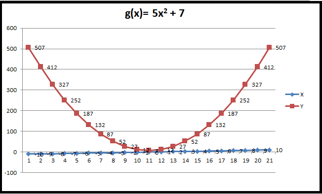

Thanks for your quick reply, I appreciate your assistance. i am quickly reading your reply. And thank you once again for the assistance, you are seriously helping me an insane amount here.
Sheez, i am still struggling a bit
I have attached the graph, however , if i go into a minus, it still gives positive values ( this graph was done on excel).
Further to this i did some more reading, and found something else which confuses me a bit more :)
Let me share this with you :
ran(g) = {g(x) | x ∊ ℤ}
= {5x2 + 7 | x ∊ ℤ }
= {y | for some x ∊ ℤ, y = 5x2 + 7 }
= {y | 5x2 = -7 } [this cannot be possible because it must be positive ]
= { y | don't know what else.. but it is confusing :D }
it cannot be equal to the codomain
OK to here, but incorrect in the next step. You are assuming that y = 0 for some x. Your graph should show you that this is not true. IOW, 0 is not in the range of g.

I double checked the graph values - and i think that the scale is just right, however y will be 7 when x = 0 :X Y
-10 507
-9 412
-8 327
-7 252
-6 187
-5 132
-4 87
-3 52
-2 27
-1 12
0 7
1 12
2 27
3 52
4 87
5 132
6 187
7 252
8 327
9 412
10 507

a) Yes, y cannot be less than 7 (equivalently, y >= 7).
b) No, y is not a multiple of 5, but y - 7 must be a multiple of 5. Further, y - 7 must be a multiple of 5 such that (y - 7)/5 is a perfect square. For example, y = 12 satisfies these criteria, because 12 - 7 = 5, and 5/5 = 1, which is a perfect square.
However, I think you're getting a bit lost in the weeds. All you need to do is find a number in Z (the domain of g) that is not also in the range of g. If you can find such a number, which should be easy now, you can say whether g is surjective.
