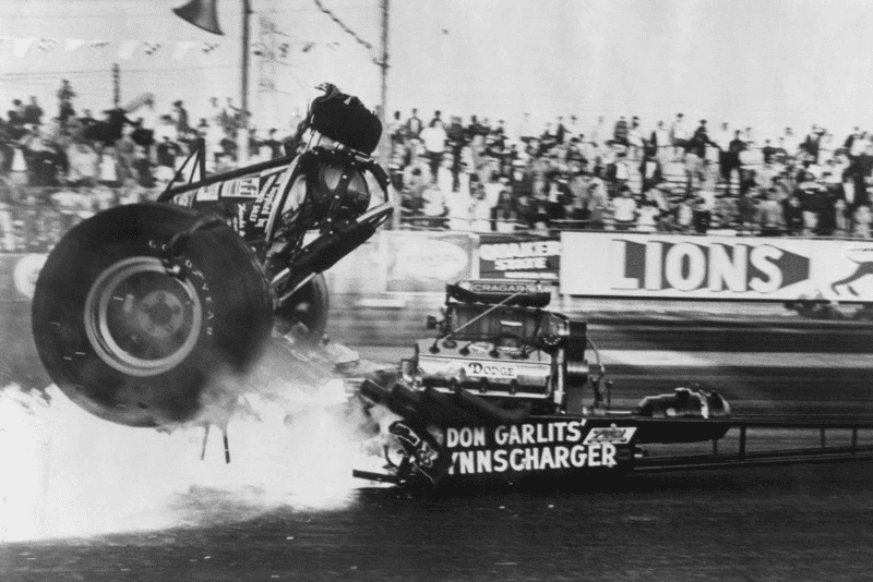

Back in the day the slingshot dragsters (drag racing vehicles made to only have maximum acceleration, had the driver positioned like a slingshot with cockpit setting in back of the rear end differential for maximum traction . Maximum weight was placed on the rear drag slick tires. This set up had great advantage until the engine horsepower
was overcoming the drag slick tires traction and the tires smoked big time. Loss of traction by too much HP. Many drag races lost due to lack of traction.
Someone figured out that by reducing the pressure plate spring force, you could hook up the drag slicks and have more traction by intentionally slipping the clutch. This was true but also added a death threat in the fact you create a hand grenade and you literally had a time bomb right under your legs waiting to explode.
Slipper clutches killed a lot of drag racers until Don Garlits went thru this process and lost his foot. Recovering in the hospital, the sage innovator developed the first working rear engine dragster design placing the driver in front of the engine and clutch package.
One evolution as to use multi clutches of smaller diameter to take up the load and disperse the heat over many discs and prolong the fatal clutch detonation. Also you had a lower rotational moment as the discs were much smaller in diameter and helped vehicle acceleration.
So you now see 4 ½ diameter clutch packages compared to the old 12 inch single disc clutch design and more improved clutch material. Asbestos was not too healthy I may add.
I did not know that! "Necessity is the mother of invention"... :smile:
Ranger Mike said:
Holy crap!
This was in 1970 with a 1600 horsepower engine. Today the dragsters have 7000 horsepower engines. Material evolution of clutch material and multi disc packages had to evolve.
