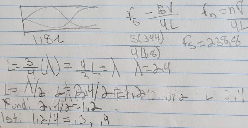

Standing sound waves are produced in a pipe that is 1.80 m long.
1) If the pipe is closed at the left end and open at the right end, determine the locations along the pipe (measured from the left end) of the displacement nodes for the first overtone.
2) If the pipe is closed at the left end and open at the right end, determine the locations along the pipe (measured from the left end) of the displacement nodes for the second overtone.
(4 / 3) * L = lambda
1st overtone: L / 4, (3 * L) / 4
2nd overtone: L / 6, (3*L) / 6, (5 * L) / 6
(4 / 3) * (1.8) = 2.4 = lambda
1st overtone: 2.4 / 4 = .6; (2.4 * 3) / 4 = 1.8

Hey, @vel, please use ##\LaTeX## for mathematical expressions ##-## there's a link to a guide at the lower left area just below the reply box ##-## using ##\LaTeX## makes what you are expessing more clear for your fellow PF members.

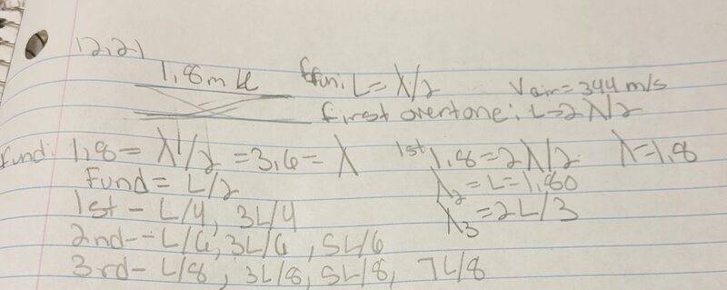

I have no scale information given, sadly, but they're two different overtones. The first half of the problem was an open pipe, and I managed that fine, but what I've tried for this has been wrong. I don't have access to the question itself right now (the site crashed on me) but I have my work drawn out.
It's the same pipe, same length, but it's open and I had to find fundamental as well as third overtone displacement nodes
Handwritten notes on lined paper: a pipe of length 1.8 m with fundamental L = λ/2 and first overtone L = 2λ/2, v_air = 344 m/s, and lists of node positions for harmonics.
Fundamental: lambda = 1.8 * 2 = 3.6
Fundamental node: 1.8 / 2 = .9
1st: 1.8 / 4 = .45, (1.8 * 3) / 4 = 1.35
(so on and so forth following that pattern)
As I said, I've tried similar with one side closed and one side open, but my answers have been wrong

Hi @vel. Please note:
Your working is difficult to read/follow.
You have thrown away marks by forgetting to include units.
You do not need to find frequency or wavelength (though you can if you want to do it the long/hard way!).
Your answers are incorrect.
On your drawing for Q1, clearly mark the tube length (1.8m) and mark the displacement node positions (‘N’). You should then be able to answer the question using only the diagram and primary school maths.
Post your updated drawing if you are still struggling.
Q2 is done the same way.
Edit. Both questions are about the same pipe - closed at the left end and open at the right end. Make sure that's correct.

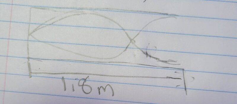

I have redrawn my diagram, but we've only done this sort of problem mathematically in class--I have no idea where the nodes should go, not even half-decent guesses. It's why I was trying to find the frequency and wavelength.

Node and antinodes on a standing wave are as shown here:
https://s3.amazonaws.com/bucketeer-...mages/000/001/166/original/02_.jpg?1591474020
Note that the distance between a node and an adjacent antinode is always 1/4 of a wavelength. So your diagram shows 3/4 of a wavelength = 1.8m. Can you now mark the nodes and work out the distances of the nodes from the left?
