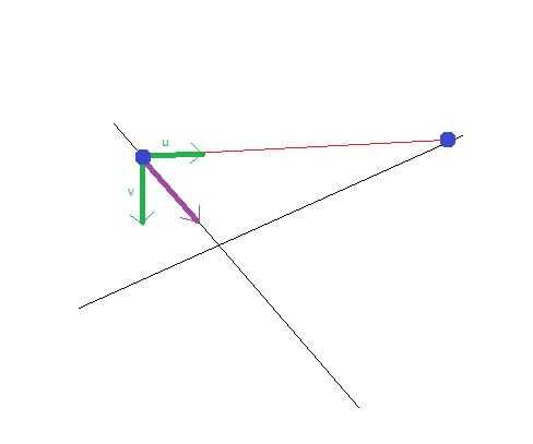

There are two particles. There are moving equally on two intersecting lines to intersection. On time t=0 is the distance of two particles d. The velocity of one particle relative to the other has a projection u in the direcion of d. In direction perpendicular to d is the projection v. The size of velocity of the particle relative to the other is V.
Task: find the shortest distance of particles and the time (r*,t*)
Answer: r*=dv/V; t*=du/V2

V2=v2 + u2
I think I have to find a function which expresses the distance of the particles in time. I have to find extreme of the function - the shortest distance. However, I don't know how create this function.
You can introduce a coordinate system. A good choice would be to have d aligned with one coordinate. What is the distance in this coordinate as function of time? What about the other coordinate?
Thanks. I found simplier solution where I don't need coordinates :)
