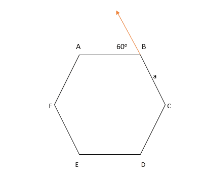

Six particles situated at the corners of a regular hexagon of side a move at ##a## constant speed ##v##. Each particle maintains a direction towards the particle at the next corner. Calculate the time the particles will take to meet each other.
Speed = distance/time
When I first read the question, it didn't occur to me that these particles would ever meet or catch up with their neighbors. They are all traveling from one vertex to another with a velocity ##v## and a distance ##a##, all either clockwise or anticlockwise right ?
The question says "Each particle maintains a direction towards the particle at the next corner." it's not clear if all the particles are moving around the center of the hexagon in the same direction (clockwise or anticlockwise) or whether some particles are moving towards each other.
If we consider two particles moving towards each other, we get ##time = \frac{distance}{speed}## so ##t = \frac{\frac{a}{2}}{v}##
But the answer is ## \frac{2a}{v} ##
The question also says "Calculate the time the particles will take to meet each other." does this mean the all particles are going to meet each other ?
I saw one answer online which said for the particle at point C.
##velocity = v cos \theta = v cos 60 = \frac{v}{2}##
## t = \frac{a}{v/2} = \frac{2a}{v} ## but why would the particle at B stay there ? It would have moved to point A.
The hexagon must simultaneously be shrinking and rotating.

Alright, so the hexagon is shrinking and rotating, but then all the particles are traveling at the same speed towards the next vertex.
When the particle at C has a velocity ##v## at a direction 600 to the horizontal.
Its horizontal component will be ## v\over 2 ##, this is less than the magnitude of ##v## that the next particle is traveling at, in the horizontal direction from point B to A.
So, the relative speed will be ##v - \frac{v}{2} = \frac{v}{2}##.
As ##a## decreases, the relative speed remains the same ? And then at some point ##a## becomes zero that's when they meet right ?
For every 600 rotation, the particles manage to move to the next vertex ?

Its simpler than that. You start a distance "a" from the particle ahead. You travel directly at it with relative speed v/2 as you have shown. How long to meet? Not a difficult calculation (in the appropriate reference frame!)

If you are saying ## time = \frac{distance}{speed} ## so, ## t= \frac{a}{v/2} = \frac{2a}{v}##, I get that, but I can't visualize it. The particle ahead is not slowing down, nor is the particle chasing it speeding up, how are they ever going to meet if the particles are dimensionless and the hexagon shrinks forever ?
No. Because the rotation accelerates they meet in a finite time.
