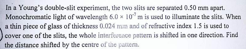

I am rather convinced that "Find the distance shifted by the centre of pattern . " is not the exact wording of the exercise. What does it say, exactly ?

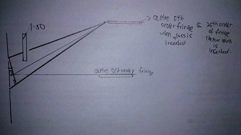

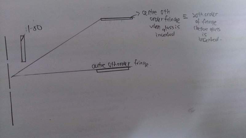

here's my drwaing the original question

Good work: the second picture makes clear that the exercise isn't top quality didactics: we indeed have to "invent" a distance scale. And your rendering of the text is completely correct. It's the text itself that is cruddy (and I am not a native english speaking lingo expert).
The first picture can now be completed (it doesn't show any light rays yet, does it!):
Draw a ray from each slit to the top centre and mark the difference in geometrical length of the paths (the optical path difference is zero, remember?).

how should I proceed from here?

difference in geometrical length of the paths is the length of the little piece from lower slit to the perpendicular. Has to be how long to make the two optical path lengths equal ?
Same picture but without the glass would point to which order maximum or minimum ?
1+1 = 2:
Central maximum shifts to ... on the same/opposite side of the slit with the glass in front.
And this is at an angle ... wrt the axis
