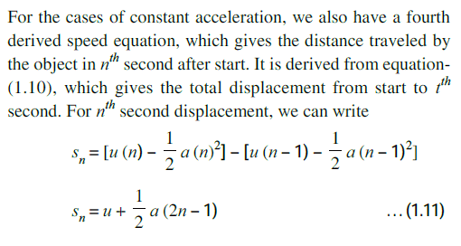

Hi! I don't understand why is made the difference between the n second and the (n - 1) second. Can anyone help me? Thanks!
The distance traveled in the nth second is the distance traveled in the first n seconds minus the distance traveled in the first n-1 seconds.
But why anyone would bother to develop such an equation (to be remembered?) is beyond me, especially since it breaks down if using different units for time.
