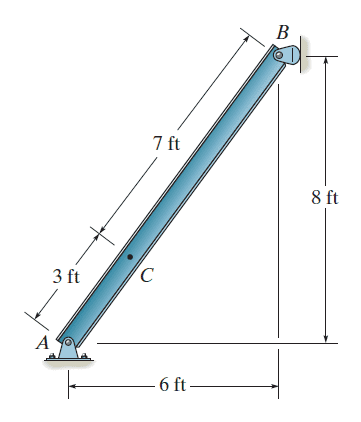

The beam weighs 280 lb/ft. Determine the internal
normal force, shear force, and moment at point C.
Equations of equilibrium
I'm having problem in drawing the distributed load (weight per foot) for the inclined beam as it shows.
should it be rectangular? if so shouldn't the distributed load be vertical down as the resultant weight at the centroid (W)
Diagram of a straight inclined beam pinned at lower-left point A on a support and at upper-right point B on a bracket, with midpoint C marked; labels show 3 ft from A to C along the beam, 7 ft from C to B, 6 ft horizontal span and 8 ft vertical height.

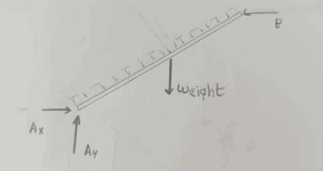

please help me understand how to draw the free body diagram for this one.
Hand-drawn free-body diagram of an inclined beam with a row of short downward distributed-load arrows along its top, a single downward arrow labeled weight at the center, a pin reaction labeled Ax and Ay at the lower left end, and a horizontal reaction labeled B at the upper right end.
If I draw it as Triangle it must be wrong (reason I want to is because I could make the Distributed load vertical then).
The distributed weight is $$\frac{dm}{ds}dsg$$ where ds is differential length along the bar; its direction is vertically downward.

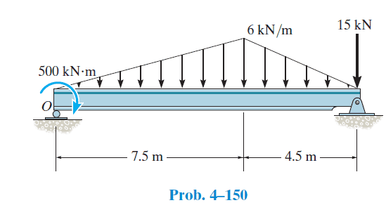

Beam diagram labeled Prob. 4-150 with a pin support at O on the left and a roller support on the right, a 500 kN·m couple at O, a triangular distributed load peaking at 6 kN/m, a 15 kN downward force at the right end, and spans of 7.5 m and 4.5 m.

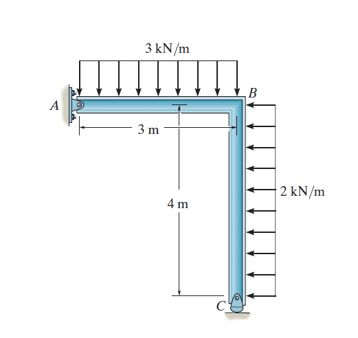

  • Structural diagram of an L-shaped frame pinned at A on the left and pinned at C at the bottom right, with B at the upper right corner. A downward distributed load of 3 kN/m acts on the horizontal member, which spans 3 m, and a horizontal distributed load of 2 kN/m acts leftward on the vertical member, which is 4 m tall.
  • Beam diagram Prob. 4-150 with a pin support at the left end O and a roller support at the right end. A 500 kN·m couple acts at O. A triangular distributed load rises from 0 to 6 kN/m across 7.5 m and falls back to 0 over 4.5 m. A 15 kN point force points down at the right end. Dimensions 7.5 m and 4.5 m are marked.

The distributed load should be in the direction of the resultant weight force. Taking a slice of the beam doesn't change its direction, just the magnitude of the resultant.
Right, but how do I draw the distributed load going vertically down?
like this:

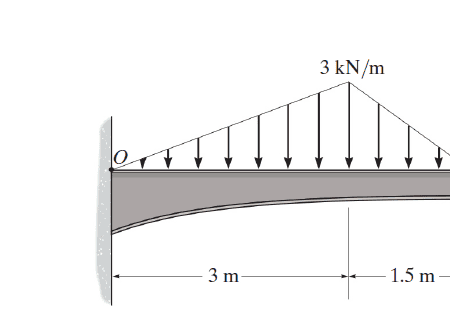

Cantilever beam fixed at a wall at point O, with a triangular distributed downward load rising to 3 kN/m at 3 m from the wall, then falling to the right over a further 1.5 m, with dimension labels 3 m and 1.5 m.

The weight per unit length of the beam is constant ( i.e. a uniformly distributed load), there is no "triangle" shaped distribution here. Those are representative of a changing distributed load over the span.
If you imagine rotating the beam to horizontal the distributed load from its own weight just tends to:
Diagram of a horizontal beam with five equally spaced downward red arrows along its top, forming a uniform load, with a horizontal arrow pointing left at the left end and a dark blue cylindrical beam below.

Mohmmad Maaitah said:
°°Homework Statement: The beam weighs 280 lb/ft. Determine the internal
Relevant Equations: Equations of equilibrium
Just imagine the extreme case of 90° Inclination.
The beam becomes a column then.
The total weight will still be the same, only that “less equally distributed”.

I think the common misconception with distributed loads is that the arrows represent forces, when they actually represent the force gradient ## \frac{dF}{dx} ##. This is what I think your mix up is, given that you think the shape of the distribution should be triangular. The force increases linearly as we progress along the beam, but the gradient (the distributed load) is uniform.
