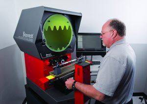

Operator in a grey shirt adjusting a part on the stage of a large benchtop optical comparator, with the circular magnified profile screen visible on the front of the red-and-black machine.
The optical comparator can be used where the item being measured is smaller than the optical collimation lenses employed. For articles that are too large for that, you must use a 2D measuring machine.
Or possibly add some optics between the object and the comparator to create a smaller image. However you still have the same perspective problem with the new optics vis-a-vis the workpiece.
In general, even comparators do best when measuring distances on a plane. I have seen installations where the comparator projection screen that you are viewing has the outline of the part drawn on it. This can compensate for the perspective problem of 3D parts.
And to decrease the system cost, you can use a video camera, a large display, and the camera lens can be whatever suits the application. And because no lenses are perfect, you then have to calibrate the system.
Cheers,
Tom
The magnification of an optical comparator increases the effective resolution of the human eye to about 1 μm. The optical comparator is then equivalent to a go/no-go gauge.
For the accurate measurement of large objects, stable temperatures are more important than magnification.
