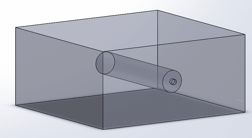

Design:
We need angular field of view to equal 2.5, so will have a collimating tube of 110 cm and an aperture of 5 mm assuming the detector is a point.
2.56 = arctan(5/110), painted black with 90% absorbance.
Here is a CAD of the optical block.

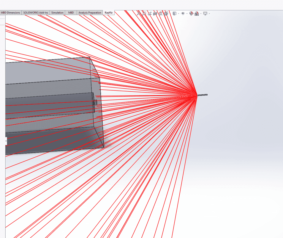

Where things go astray...
Simulation:
I was curious how much sunlight would enter the aperture and be collimated down to the "detector" (there is no detector in the model).
I tried to simulate the sun here by knowing that the ratio of the diameter to the distance (.0093 = diamter:distance) from Earth is about .0093. So at .1 meters away the size of the sun would be 930 microns.
Now using RayViz a package within Solidworks I made a disk, which is the "sun" here and I tried plotting the rays from the surface of this disk, and well doesn't look to great! Here I have a lambertian surface meaning the rays leave at all angles of the disk. I don't know how to only focus the rays within instruments domain but nonetheless I think I am doing something wrong, not with the software but my thinking...The suns light is diffused and focused more than a lambertian surface...
So, how would one simulate the sun, should it be a point source?
No. You even calculated the angle !
And it should be at practically infinity, not at a few decimeter
Ha! True, I may have been rambling at that point.
However, the sun in this model is scaled. As I mentioned before,
.0093 = diameter of the sun / distance to the sun from Earth. Therefore, at 1 decimeter, the radius should be 930 microns :)
That's not how it works. Rays from the sun come in almost parallel.
