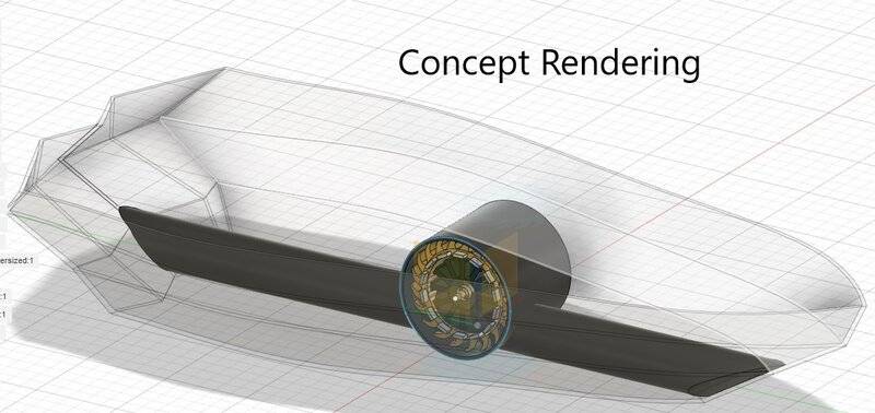

Need tips for a weird water propulsion system.

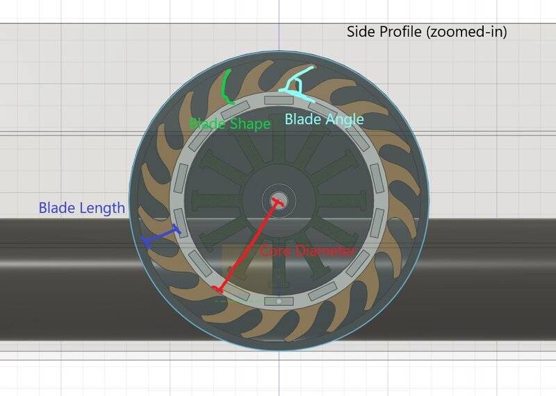

I'm not sure if you would call it a "Parallel Impeller," but the pics below should tell the story. I'm designing/3D printing my next RC boat from scratch, and I wanted to try something different from tried-and-true propeller and shaft system. Reasons?
1. Fun.
2. Using a "wet" brushless motor means I won't have to punch a hole through the hull to accommodate a rotating propeller shaft.
3. Gyroscopic stabilizing? Maybe?
4. Boat being "pulled" from the front intake to help maintain heading?

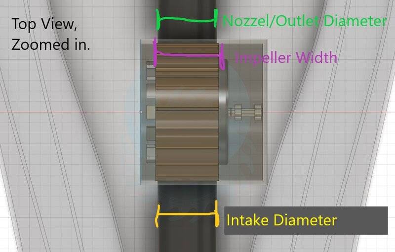

There are a ton of variables to consider in the design process, and I'd love any physics advice you have to offer regarding the specs highlighted below. I'm definitely not asking for something like the "best" anything--more just wondering if there are any rules of thumb to help guide the specs. Like "xyz is better for low speeds" or "abc will be more efficient at the cost of size."
Boat hull shape is strictly placeholder. Snarky criticism is encouraged.

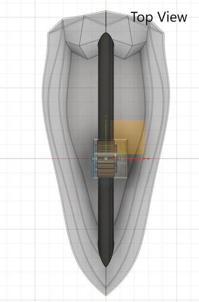

(Forgot to ask about number of blades/space between them in the above pic)
Thanks!

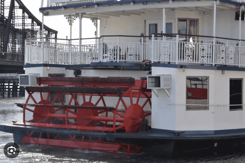

Looks like an internalized paddle wheel thing to me.
Why are you showing curved blades? As you can see from the existing design posted by @BillTre traditional ones use flat blades. It seems like your curved blades would pick up and lift excess exhaust water (costing drive energy) and toss it forward (costing momentum).

My humble opinion:
In theory, that is supposed to be working as an in-line pump.
When the casing gets full of water via centrifugal effect and high rpm's, the pumping effect will be close to zero.

If the device takes water from in front, accelerates it into a tube, to release it at the rear where energy is recovered, then the vessel will make no bow wave.
The saving in bow wave creation will be traded for wetted surface in the tube.
Then why have a pointed front on the boat ?

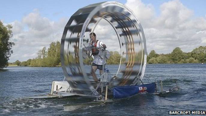

I tried a search using terms high speed paddle boat and found several good hits.
This one, at https://www.boatdesign.net/threads/fast-human-powered-paddlewheel.46084/, has a large human powered paddlewheel in "full hamster" mode:
Not as fast as you are looking for, but I could not resist posting it. A more applicable research paper discusses design variables for paddlewheel driven boats with speeds up to 32.8 knots, with a discussion of the potential for even higher speeds: https://www.marinepropulsors.com/proceedings/2011/FA3-1_Harte.pdf. An image from that paper:
The paper also discusses propulsive efficiency vs some design variables.
Then I searched high speed paddlewheel boat, and found US Patent 6743064, titled High-speed Paddle Wheel Catamaran. This patent puts the paddlewheel in a tunnel as alluded to in Post #5 by @Baluncore. And many more good hits. I almost sucked myself down a rabbit hole following them, but fortunately was able to control myself.
About 25 years ago, I built a pedal powered paddle boat. In undocumented, very informal testing, it was about 2/3 the speed of a canoe. It was good in shallow water, and very good in thick weeds.

Yes and no. My thought was for the chamber to be flooded, so that instead of lifting water, it would technically be maintaining a spin cycle that jets out the back. I'm catching vibes from the others that the flooded-cyclone-chamber-thing might not pan out, though.
The design was inspired by taking apart one of these. The inside looks a lot like my curved blades. Granted, it's the reverse function, but even though that one is intended to "catch" energy, my thinking was that it might still be better to "scoop" water from the intake. I was also envisioning the chamber flooded, and creating a sort of cyclone would be a good thing.
...and in my head that all worked perfectly and made outstanding sense. Sounds like no?

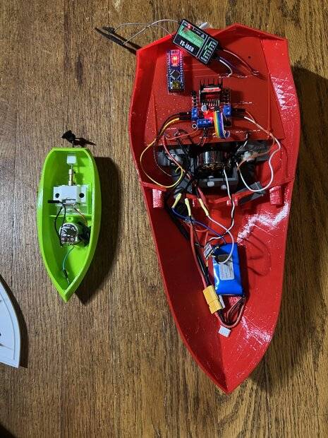

My end goal is learning enough to design something autonomous and ocean-faring that can survive under those conditions, which is why I'm experimenting with internalizing as many components as possible--save from seaweed, crushing storm waves, etc.

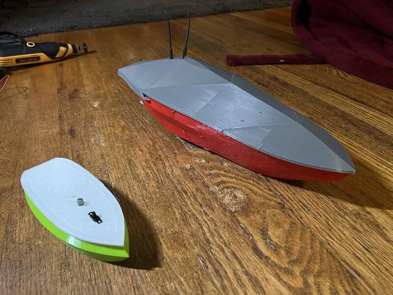

This next one will only be, like, iteration 3 of 10 toward that goal. 1 and 2 are below, "Slippy" and "Peppy".

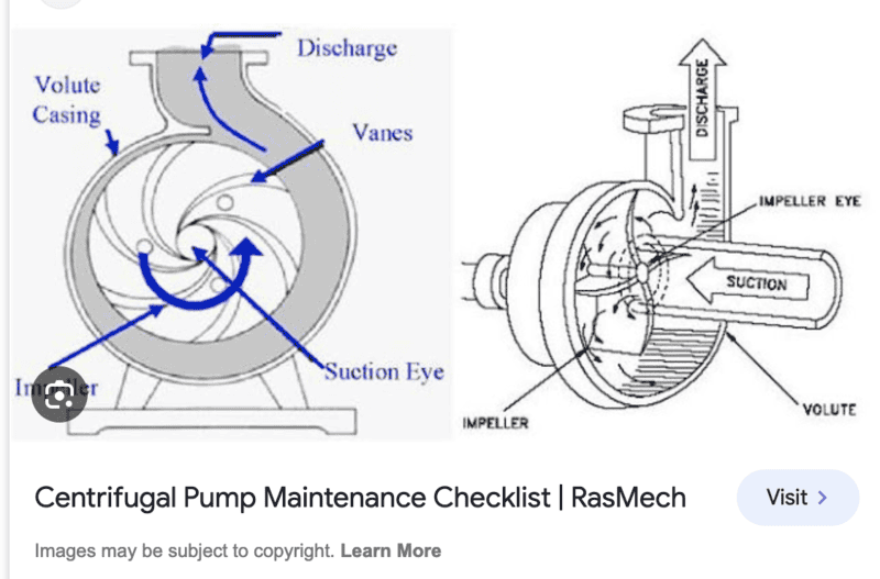

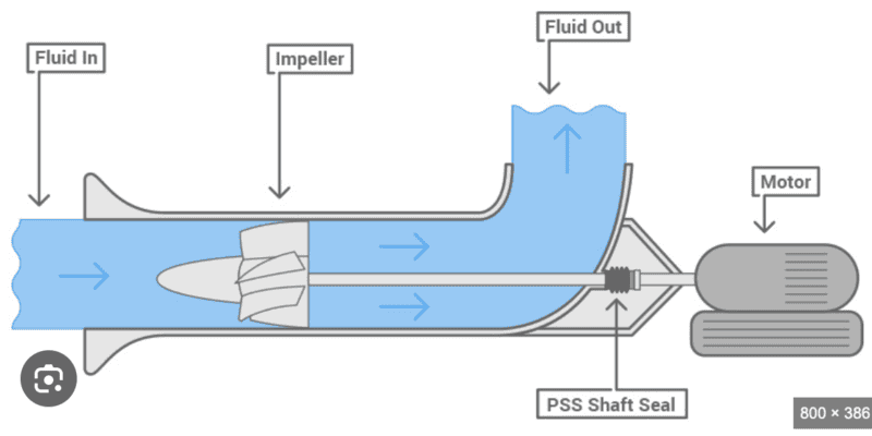

A flooded impeller chamber would be like a centrifugal pump. They suck the water in the center and throw out to their periphery by centripetal force. The water is collected by the housing and directed to a pipe.
An axial pump uses a propeller in a pipe:

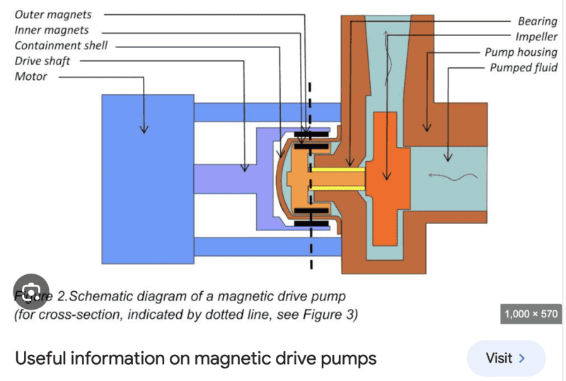

Magnetic drive pumps are common.
They separate the motor and impeller more cleanly (no seal around a drive shaft):
The ideal situation might be a mag drive directly driving a propeller from outside the pipe so you could get a completely linear flow.

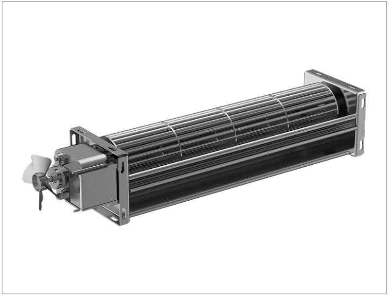

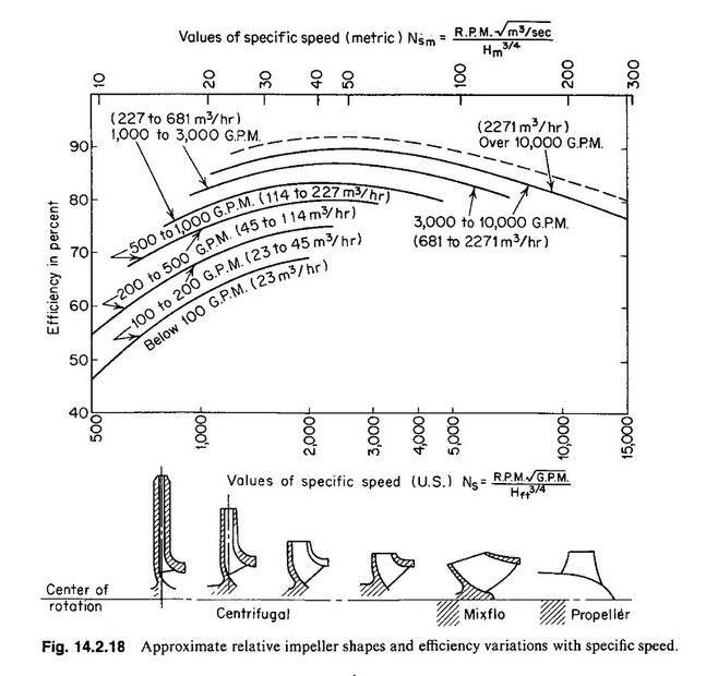

Your idea is similar to a type of air blower known as a cross flow blower. These blowers are used in applications where low profile and low cost are both important. Those motel HVAC units under the window with the annoying noisy whine use these blowers. They are notable for their low cost, loud annoying noise, low efficiency, and low cost. Especially low efficiency. Since air and water are both fluids, I would expect that a low efficiency air blower would also be a low efficiency water mover. A typical cross flow blower is shown below:
Centrifugal water pumps come in different designs, where the optimal design depends on the ratio of discharge head to total flow. This is expressed by the parameter specific speed. Specific speed is not dimensionless, so it is necessary to know the units. Even though it is not dimensionless, it is useful. The following chart shows how optimal pump impeller designs are a function of the specific speed.
This particular chart is from Marks' Standard Handbook for Mechanical Engineers, 9th Edition. A similar chart in Centrifugal and Axial Flow Pumps by Stepanoff has a more detailed discussion. A boat drive system moves a large amount of water at low discharge head, and the specific speed chart shows that propellers are the optimal choice for that application.
Fortunately, efficiency is not the only criteria that you can use to design a boat. A 30 knot paddlewheel boat would be a lot of fun, and a real attention getter.

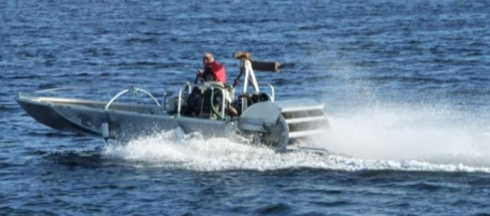

Boats that propel themselves by squirting water out of the back have been around for years, ranging from this to this.
I'd start by looking at some of those for inspiration rather than a shower pump.
