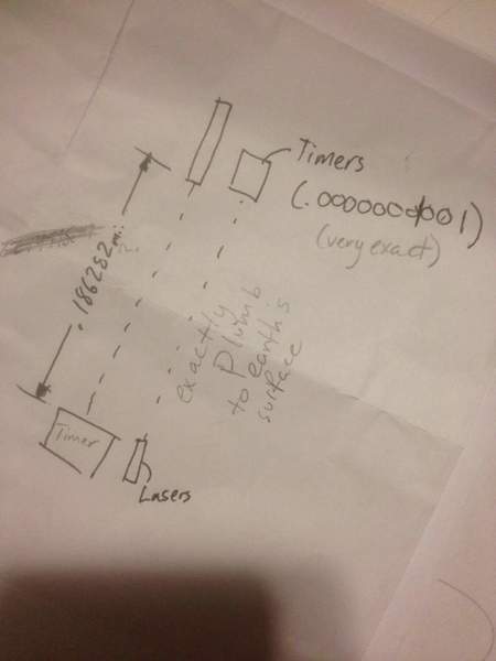

Lately, I have been giving a lot of thought to whether or not photons would have mass or not. I know most on here an on other sites say that they do not have mass, but I think differently.
If light has no mass, then theoretically, it shouldn't have any speed limit (186,282 mi/sec) because then there would be nothing to slow it down from being infinitely fast. Therefore, light must have matter, to slow it down the 186,282 mi/sec number.
I even calculated what the mass of a photon would be in a gamma ray. My calculation came out to be a mass of 2.2102189e-34 kg for a wavelength of 10^-5 nm.
Could someone please converse with me about this. I'm really loving this. I think I even have a way to test my theories. But, I am only a senior in high school and am not sure if anything like this has been done before.
Thanks :)

But, that's not the point I'm trying to make, it was just another side road off my main point, which is there's a sure-fire way to test for photon mass
Try it. You'll find that no matter how strong the gravitational field and no matter what the photon's energy, the photon takes the exact same amount of time to make the upwards climb.
The photon will lose energy as it climbs uphill, but that doesn't show up as a loss of velocity, it shows up as the photon being redshifted so that the frequency, energy, and momentum are all reduced.
