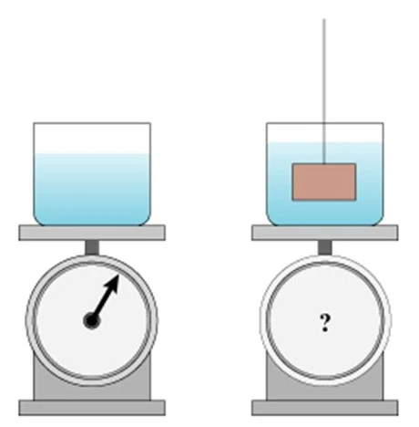

I have.
I actually gave this at the very beginning of the topic on buoyancy, mainly to judge their ability to analyze the problem and to give a rational explanation for what they think will happen. I do not penalize them for giving the wrong answer.
It's a common question that I've come across many times. You have a container of water on a weighing scale. You then lower a mass attached to a string until it is completely submerged but without it touching the bottom or any part of the container. Will the weighing scale read more, less, or the same?
In some cases, I let them discuss with other students in the class before they come up with an answer.
After they have written their answers, I actually bring out sufficient equipment and tell them to go ahead and perform the actual measurement and see if they got it right. I don't give them instruction on what to do, but I do require that they describe exactly what is done and what they observe.
After this, we then have a class discussion on the result. We discuss the wrong answer, and the reason and explanation behind the right answer, all before we learn about buoyancy and Archimedes' principle. From my anecdotal experience, students tend to remember and understand this better than just simply pouring out the concept. And this activity has WAY more student engagement in it than passive learning.

The rope will not hold the full weight of the brick (this can be derived from childhood bath time memories), thus some of the weight of the brick must be borne by the scale, causing it to increase.
No knowledge of Archimedes' principle necessary, I think.
No formal knowledge of Archimedes needed, but it would explain why the string tension decreases when brick is in the water.
With the brick in the water, the water level in the container has increased.
Thus, the pressure on the bottom area of the container has increased.
In turn, the balance registers an increase for the this situation to be in static equilibrium.

If you are teaching a class, try it. You'd be surprised at how many students got this wrong, which is why I continue to use this at the beginning of the lesson BEFORE I start on the topic. I tell my students that anyone, regardless of whether that person has formally learned physics or not, is able to answer this question.
Many students, especially ones that are apprehensive about taking a physics course, have this weird idea that all their worldly experiences somehow should be thrown out when they enter a physics class. This "riddle" is just one example where I start a topic by citing something that they already are aware of but never formally understand it.

This one does not fit for Physics, but a Biology teacher once discussed conducting an experiment or experimental design like this:
A grasshopper was put into a jar of tomato juice. The grasshopper died. The experimenter concluded that tomato juice is toxic to grasshoppers.
I wouldn't consider this a riddle. Riddles confuse students who don't understand what they are supposed to be learning. Are they learning how to be clever or are they learning what we call physics?
Your question is very good. Back in the 1990's I would have used this as a Hewitt-like next time question, or one of his "check your neighbor" questions. But when clicker technology became available I would use this as a very good clicker question, and of couse get the students talking to each other. After the first vote the statistics are displayed in the form of a bar graph, showing how many students gave each answer. After that what the instructor does depends on that answer distribution. If most students got it right a few words of explanation are all that's needed before moving on. On the other hand, a large number of students giving wrong answers invites further discussion, often lively with a few students taking turns to state their point of view to the rest of the class. Look at the work done by Harvard physics professor Eric Mazur.
Most of the responders in this thread don't seem to grasp what this question is all about. The water pushes up on the submerged brick (the so-called buoyant force) so the brick must push down on water (ala Newton's Third Law).
By the way, I would avoid phrases like "the submerged mass". This confuses students. Mass is a property of an object, not the object itself.
Many of these questions that you refer to as riddles are not good test questions because tests are designed to see if the student has learned the subject matter. But these "riddles" should be designed to introduce the subject matter and get the students thinking about it. It's very important to keep reminding them of this difference. Saying it once or twice won't get the point across.
