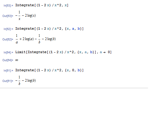

How is MM doing the integral? Is this something with a definite solution?
Limit[Integrate[(1 - 2 x)/x^2, {x, a, b}], a -> 0]
Integrate[(1 - 2 x)/x^2, {x, 0, b}]
The first one gives infinity, the second a closed solution, though technically they should be the same, right?

Strange, I must have had some weird assumptions. (Version 7)
So when I run it from a fresh start, I get that they both diverge. If I do some of my other code, NONE OF WHICH uses a,b, or x, I get this:
And if I change x-> something random and b-> something random, it does the SAME thing.

I Think I found the problem, there must be something in Feyncalc. If I do:
<< HighEnergyPhysics`FeynCalc`;
just to load it, then do the integrals , it gives the weird responses... I wonder if there is something in its definitions to handle the N-dimensional divergent integrals that is messing with this.

Probably somewhere some assumptions have been set in FeynCalc, or the option GenerateCondtions->False has been set.
The output you obtain after loading FeynCalc is the same as
Integrate[(1 - 2 x)/x^2, {x, 0, b}, GenerateConditions -> False]

Can you load FeynCalc and run "Options[Integrate, GenerateConditions]" to see if it returns the default "GenerateConditions->Automatic"?
I assume that it must be set to False, because otherwise your Out[8] would have the same conditions attached to it as your Out[3]. Then it's just a matter of tracking down what setting you've made in you FeynCalc install that would do this. Try running the "find ..." command I gave above in your FeynCalc directory.
yeah that's it.
In[1]:= Options[Integrate,GenerateConditions]
Out[1]= {GenerateConditions->Automatic}
In[2]:= <<HighEnergyPhysics`FeynCalc`;
During evaluation of In[2]:= Set::wrsym: Symbol MonomialList is Protected. >>
During evaluation of In[2]:= DumpGet::bgbf: File C:\Program Files\Wolfram Research\Mathematica\7.0\AddOns\Applications\HighEnergyPhysics\Tarcer\tarcer25.mx cannot be loaded, it is corrupted or is written on a different machine. >>
In[3]:= Options[Integrate,GenerateConditions]
Out[3]= {GenerateConditions->False}
