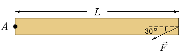

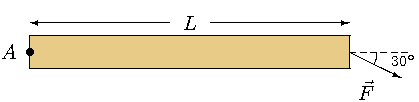

Do these two force diagrams have the same torque?
  • Thread starter NoobeAtPhysics
    Torque
NoobeAtPhysics
75
Do both these two pictures have the same moments?
Diagram of a uniform rod of length L with a pivot point labelled A at its left end, and a force F applied at the right end at 30 degrees below the horizontal.
Diagram of a horizontal rod of length L with a pivot point labelled A at its left end, and a force F applied at its right end at 30 degrees below the horizontal.
t=rF
Yes, if you use the formula, you will notice they have the same moments and direction (using right hand) . Is this correct?
Yep. Only the component of force perpendicular to the length L contributes to the torque about point A. The perpendicular component is the same in both cases.
