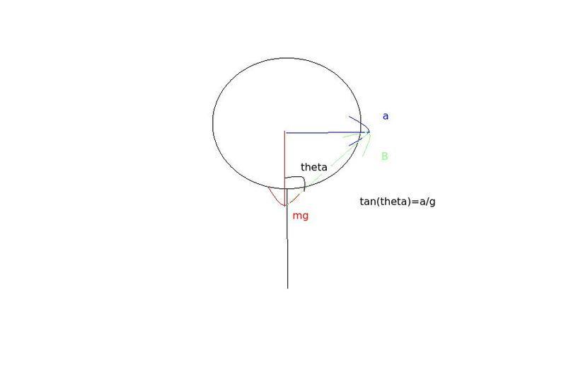

Consider a hellium balloon with negiligible mass in the bus with all windows closed.
When the bus is acclerating in ##\mathbf a=a \mathbf i##, where ## \mathbf i## is the unit vector in the positive x direction, describe the status of the balloon and explain the reason.
If we consider the massive balloon, does your answer change?
Explain the reason.
(Status: Does it tilt or not? What are the tilting diraction and angle?)
Buoyent force ##ρgV##
I know the answer might be ##tan\theta=\frac{g}{a}## or something like this, but I don't really the reason behide this.
I think it is related to physics in noninertial frames.
Any help would be appreciated.

Forget about the bus for a moment. What usually happens to the helium filled balloon and why?
The balloon will float in the air because of the density of the helium is smaller than that of air.
I just got a new idea, but don't know if it's right or not.
Because of the total force is ##\mathbf B+m\mathbf g## which equals ##m\mathbf a##, and I think the direction of the gravity is the same, therefore it is the change of the buoyant force that causes the change of the status of the balloon.
The balloon will float, or ascend?
Sorry, bad english, the balloon will ascend.
OK, why does it ascend?
Because the pressure at the lower part of the balloon is greater than the upper part of it, and, the buoyant force is larger than the gravitational force, the balloon ascends.
OK, but why do these differences exist? Do they exist in the zero gravity environment?

My answer is (b), but I don't really know how to figure out the direction and magnitude of the normal force exerted by the roof and the buoyant force which, I think, has something to do with the condition of the windows.
I think we should consider it to be floating up in the air and it is on a sting held by a student.
or at least assume that the balloon is weighted so it has a tendency to float one way up eg with the knot pointing downwards.
Perhaps it would help the OP to remember that when the bus is stationary gravity (an acceleration) is pulling the air vertically downwards. What happens when the bus and the air in it are also accelerating in another direction. It helps if you have ridden on a bus standing up!
Let me reword the original problem. Imagine you have a helium filled balloon in the standing bus. Obviously, the balloon goes up till it stops at the roof and it stays there. Now, what will happen when the bus starts to move?
