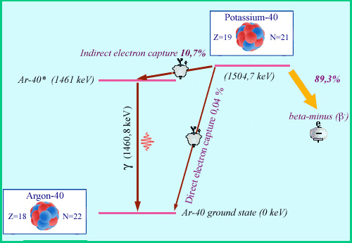

The photon is not emitted directly, the Ar-40 is formed in an excited state with some non-zero angular momentum. The emission of the photon will carry away that excess angular momentum so that the final state nuclei has spin 0. It is also thanks to this photon that we can use K-40 for radioactive dating (give it a try next valentines day!)

Nice picture from: https://www.radioactivity.eu.com/site/pages/Potassium_40.htm
