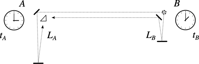

  • #62
Bosko said:
For which observer does the speed of light slows down entering a stronger gravitational field?
Let's imagine...
Let two rays of light emitted at point B arrive at (detector) point A at the same time.
Does ##L_A=L_B## for both observers?
For example, ##t_A=20 ns, L_A=6 m## and ##t_B=10 ns, L_B=3 m##.
If ##L_{AB}## is removed from both paths, we get ##2L_A=2L_B## and ##L_A=L_B##.
(Speed of light = 30 cm, or foot, per nano second)
The speed of light appears to be constant for any observer regardless of the gravitational field.
I'm interested in whether it slows down as approaches the photon sphere (or the event horizon).
It seems to me there is a lot wrong with this. Especially what you mean by certain terms. What does length mean (for an observer)? How is the length of a path through space defined for a given observer?
How is the speed of light defined in curved spacetime?
Ultimately, it seems like a simplistic analysis that doesn't take account of how theese quantities are defined.
  • #63
The initial assumption is a constant speed of light for a local observer.
It measures some local distances. ( for example using https://www.fluke.com/en/product/building-infrastructure/laser-distance-meters/417d)
The definition is self-explanatory to the local observer. (Distance 30 cm that light travels for a time unit of 1 nanosecond)
I analyse how two observers can agree on the measured distances.
I am interested in questions:
Is the speed of light the same for any observer regardless of the gravitational field?
Does light travel along the (locally) shortest path between two points?

  • #66
PeterDonis said:
It depends on what you mean by "the speed of light". The light cone structure of spacetime is invariant. But the "speed of light" defined by non-local measurements, such as two observers at different altitudes in a gravitational field exchanging light signals, might not be.
Are those two observers are static?
How they exchange light signals to get different results?

  • #68
You stand at the top of a building and I'll stand at the bottom. We use a ruler to measure the distance between us and we will agree that value - we must, because we use the same ruler at the same time in the same way.
Now we bounce radar pulses off each other. We do not agree the return time due to gravitational time dilation.
We agree distance travelled but not time taken. This we do not agree speed.
  • #69
We should agree on the electro-magnetic radiation speed but not agree on the distance - the height of the building.
The ruler is the same but we can't agree about its length.
Let's imagine that time ticking 1/10 slower on my clock then on yours ...
For me the radar pulse goes up and back in 600 nano seconds ...
and I am calculating 300 nano seconds times 1 feet (30 cm) = 300 feet (100 meters )
For you the radar pulse goes down and back in 660 nano seconds ...
and you are calculating 330 nano seconds times 1 feet (30 cm) = 330 feet (110 meters )
Any speeds we measure are the same but time and distance measured by me have to be multiplied by 1,1 to agree with your measurement
  • Skeptical

  • #70
Yes.
Their clocks will measure different round-trip travel times for the light signals.

  • #73
Ibix said:
in that case the two observers don't share a notion of space
I'm not sure what case is being discussed here. There is no case where two static observers at different heights don't agree on the height difference between them.

  • #76
Ibix said:
Ok. But in that case the two observers don't share a notion of space, so light didn't follow the same spatial path for them.
The light follow the same spatial path but length of that path is different for different oservers
If clock A ticks 2 nano seconds while clock B ticks 1 nano second ...
They will agree on any speed ##\frac{\Delta x}{\Delta t}## but not on distances and time passed
Any distance for observer B (bottom) is 2 times smaller then the same distance for observer A.
