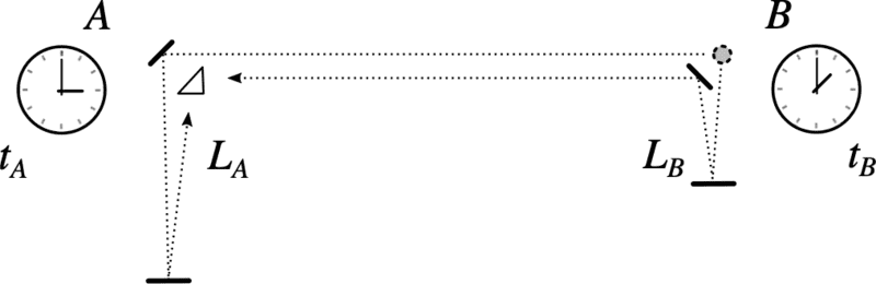

For which observer does the speed of light slows down entering a stronger gravitational field?
Let's imagine...
Let two rays of light emitted at point B arrive at (detector) point A at the same time.
Does ##L_A=L_B## for both observers?
For example, ##t_A=20 ns, L_A=6 m## and ##t_B=10 ns, L_B=3 m##.
If ##L_{AB}## is removed from both paths, we get ##2L_A=2L_B## and ##L_A=L_B##.
(Speed of light = 30 cm, or foot, per nano second)
The speed of light appears to be constant for any observer regardless of the gravitational field.
I'm interested in whether it slows down as approaches the photon sphere (or the event horizon).
  • #56
How is that even possible? Two different rays would be emitted from point B at different times, and that means they would arrive at point A at different times.
Yes. The time taken for light to travel is what is different for the two observers. The simplest way to test that is for each observer to send a round-trip light signal that reflects off a mirror at the other observer's location, and then compare the round-trip travel times by the two observers' clocks.
  • #58
Both ray are emitted from the same source and at same time from point B ( see image)
  • #59
Then what's the point of having two rays? The two rays aren't telling you anything that one ray wouldn't tell you.
  • #60
By adjusting the LA, you can set them to arrive at the same time.
Then ##L_A=L_B## for both observers.
