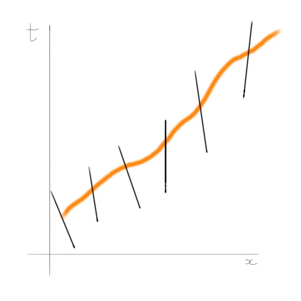

I think you are thinking of a process something like this. Draw a spacetime diagram in some coordinate system and add the (orange) worldline of the light pulse:
Spacetime diagram with horizontal axis x and vertical axis t, showing a wavy orange worldline of a light pulse rising from lower left to upper right.

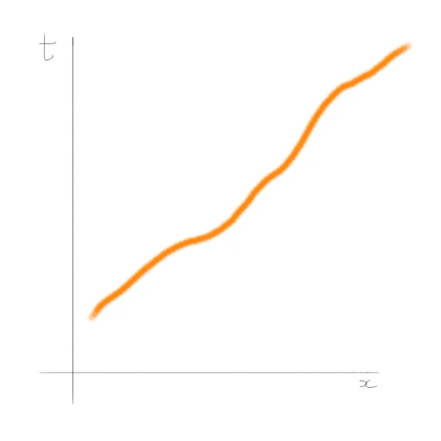

Pick a series of events in some sense evenly spaced along the line (you might choose fixed intervals of an affine parameter along the null path, or fixed coordinate time intervals) and draw timelike dividing lines between small regions (black):
Spacetime diagram with horizontal x axis and vertical t axis, showing an orange wavy worldline rising to the upper right and five black line segments drawn across it at varying tilts.

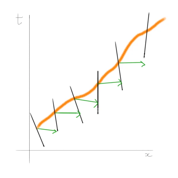

Measure the spacelike distance between each dividing line and the next along a line orthogonal to the divider (green):
Spacetime diagram with horizontal x axis and vertical t axis, showing a wavy orange worldline rising to the right, with black timelike dividing lines and green spacelike arrows between successive dividers.
Sum the spacelike distances. Take the limit as the even spacing between dividing lines reduces to zero.
Am I right? If so, the issue appears to be the freedom to choose the direction of the timelike dividing lines. I don't think there's a unique choice (even in flat spacetime) and the final result will depend on your choice of scheme for picking them.
