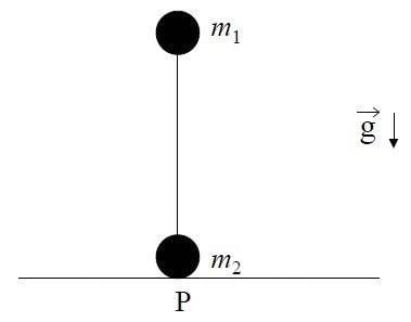

Hi. There are two masses connected by a massless bar, and from the unstable equilibrium position shown in the figure is slightly inclined so it falls down, being the final state of the system that both masses are in contact with the surface. There is no friction between the floor and m2. The problem is to find the horizontal component of the velocity of the center of mass.
I think that since there is no friction, and gravity being the only outside force that acts on the system, the center of mass will fall straight down, so there will be no horizontal velocity of it. So is this right?
[tex]Vx = \frac{m_{1}V_{x1}+m_{2}V_{x2}}{m_{1}+m_{2}} = 0[/tex]

Thanks in advance.

Your analysis seems correct to me.
