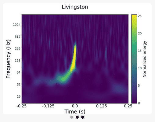

This would be a typical representation of the signal frequency of a BH merger.

In principle yes, in practice no.
The frequency depends on the black hole masses, in general those are not known in advance - the masses are determined by the frequency spectrum. This is different from electromagnetic radiation, where we can use spectral lines with well-defined frequency.
Even if we get lucky enough to find a gravitational wave source where we have an independent way to measure a mass, the precision won't be very good.
And to make it even worse, the current sensors can only measure mergers up to ~1 billion light years away. That might be sufficient to see the overall expansion, but measuring the acceleration of that expansion would need larger distances.
