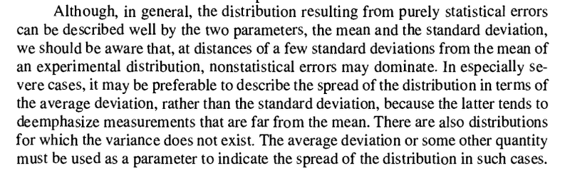

I did not understand of the non-existence of variance.
What does it mean?

I assume that either a variance of zero is meant, or that it cannot be defined, e.g. because the expectation value of the variable isn't finite or the variance itself isn't.

Sometimes a random variable with infinite second moment is said to have no variance.

So the above is the reference from the book
It ("no variance") means "cannot be defined" or "is infinite". There can be several reasons for it as mentioned in previous posts. The author talks about distributions that don't behave mathematically nice. In this context, every distribution is possible and therefore also those, for which the variance cannot be defined (or is infinite). Since it is a very general statement, it cannot be said, what exactly is meant. And it isn't important here anyway.

For an experimental distribution, mean and variance can always be computed. I think you need to clarify what you mean when using the terms: average deviation, standard deviation, variance.

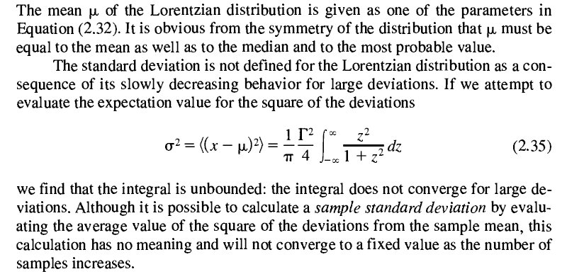

This is a snapshot from the page that follows, from the same book.

The reason is that your picture is Cauchy again. If you scroll down to "Explanation of undefined moments" in its wikipedia entry, here:
https://en.wikipedia.org/wiki/Cauchy_distribution#Explanation_of_undefined_moments
you can get a flavor what is going on. The issue is mathematically speaking, your text is wrong. It confuses the principal value with the Cauchy expected value, which isn't well defined. (Why? As shown in wikipedia, start with the two different finite integral (or even approximate riemann sums) bounds of [-a,a] and [-2a, a] and take a limit as a -> infinity. The result has the same bounds yet different values. This is a subtle mathematical point tied in with one to one mapping, and something that your text does not seem to understand. Put differently, your author is positing [-a,a] without realizing it.)
One solution to this, would come from Jaynes. He would recommend you basically always start with a finite case, state exactly what you mean, and take limits -- people make egregious errors when they start in infinity.
What your book is trying to say is that the second moment $$E[X^2] = \infty$$ $$variance = E[X^2] - E[X]^2 = \infty - ?$$ which is not in the real number system. I'd get a different book, though.

Oh wow. The book actually says the mean of the Cauchy distribution exists. That's just sad. I also suggest to throw away the book and get a better one (Taylor).
