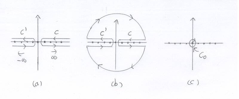

We will evaluate
\begin{align*}
\sum_{k=1}^\infty \frac{(-1)^k \sin \dfrac{\pi k}{2}}{k} = - \sum_{k=1}^\infty \dfrac{(-1)^{k-1}}{2k-1}
\end{align*}
I will express the sum via a complex contour integration. It employs the fact that the function
\begin{align*}
\dfrac{\sin \dfrac{\pi z}{2}}{\sin \pi z}
\end{align*}
has simple poles at all integer values except when ##\sin \dfrac{\pi z}{2} = 0##.
This allows us to write
\begin{align*}
\sum_{k=1}^\infty \frac{(-1)^k \sin \dfrac{\pi k}{2}}{k} = \frac{1}{2i} \oint_C \dfrac{\sin \dfrac{\pi z}{2}}{z \sin \pi z} dz
\end{align*}
where the contour ##C## is defined in fig (a).
We have
\begin{align*}
2 \sum_{k=1}^\infty (-1)^k \frac{\sin \dfrac{\pi k}{2}}{k} & = \sum_{k=1}^\infty (-1)^k \frac{\sin \dfrac{\pi k}{2}}{k} + \sum_{k=-1}^{-\infty} (-1)^k\frac{\sin \dfrac{\pi k}{2}}{k}
\nonumber \\
& = \frac{1}{2i} \oint_{C+C'} \dfrac{\sin \dfrac{\pi z}{2}}{z \sin \pi z} dz
\end{align*}
where the contour ##C'## is defined in fig (a). We complete the path of integration along semicircles at infinity (see fig (b)) since the integrand vanishes there. Since the resulting enclosed area contains no singularities except at ##z=0##, we can shrink this contour down to an infinitesimal circle ##C_0## around the origin (see fig (c)). So that
\begin{align*}
\sum_{k=1}^\infty (-1)^k \frac{\sin \dfrac{\pi k}{2}}{k} = \frac{1}{4 i} \oint_{C_0} \dfrac{\sin \dfrac{\pi z}{2}}{z \sin \pi z} dz
\end{align*}
We expand the integrand in powers of ##z## about ##z=0## and isolate the ##z^{-1}## term. We get
\begin{align*}
\dfrac{\sin \dfrac{\pi z}{2}}{z \sin \pi z} & = \dfrac{\frac{\pi z}{2} - \cdots}{z [\pi z - \frac{1}{3!} \pi^3 z^3 + \cdots]}
\nonumber \\
& = \dfrac{\frac{\pi z}{2}- \cdots}{z^2 \pi [1 - \frac{1}{6} \pi^2 z^2 + \cdots]}
\nonumber \\
& = \dfrac{\frac{\pi z}{2} - \cdots}{z^2 \pi} (1 + \frac{1}{6} \pi^2 z^2 + \cdots)
\nonumber \\
& = \frac{1}{2z} + \cdots
\end{align*}
So that,
\begin{align*}
\sum_{k=1}^\infty (-1)^k \frac{\sin \dfrac{\pi k}{2}}{k} & = \frac{1}{4 i} \oint_{C_0} \dfrac{\sin \dfrac{\pi z}{2}}{z \sin \pi z} dz
\nonumber \\
& = \frac{1}{4 i} (-2 \pi i) \frac{1}{2}
\nonumber \\
& = - \frac{\pi}{4} .
\end{align*}
So that
\begin{align*}
\frac{\pi}{4} = \sum_{k=1}^\infty \dfrac{(-1)^{k-1}}{2k-1} .
\end{align*}
