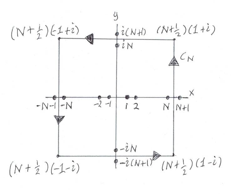

Consider the square contour shown in Fig 2 with corners at ##(N+\frac{1}{2}) (1+i)##, ##(N+\frac{1}{2}) (-1+i)##, ##(N+\frac{1}{2}) (-1-i)## and ##(N+\frac{1}{2}) (1-i)##. This contour encloses all the points at ##-N, - (N-1) , \dots, -1,0,1, \dots , N-1,N##. We will prove that the integral
\begin{align*}
\oint_{C_N} \dfrac{\sin \dfrac{\pi z}{2}}{z^3 \sin \pi z} dz \qquad (*)
\end{align*}
vanishes ##N \rightarrow \infty##. This will imply
\begin{align*}
\sum_{n=0}^\infty \dfrac{(-1)^n}{(2n+1)^3} & = - \sum_{n=1}^\infty \dfrac{(-1)^n \sin \dfrac{\pi n}{2}}{n^3}
\nonumber \\
& = - \frac{1}{4i} \oint_{C_0} \dfrac{\sin \dfrac{\pi z}{2}}{z^3 \sin \pi z} dz
\nonumber \\
& = - \frac{1}{8i} \oint_{C_0} \dfrac{1}{z^3 \cos \dfrac{\pi z}{2}} dz \qquad (**)
\end{align*}
where ##C_0## is an infinitesimal clockwise contour around the origin.
Handwritten diagram of a square contour in the complex plane with corners (N+1/2)(-1+i), (N+1/2)(1+i), (N+1/2)(1-i) and (N+1/2)(-1-i); the real and imaginary axes are marked with points -N-1, -N, -2, -1, i, 2, N, N+1 and iN, i(N+1), -iN, -i(N+1), and the contour is labelled C_N.
Fig 2.

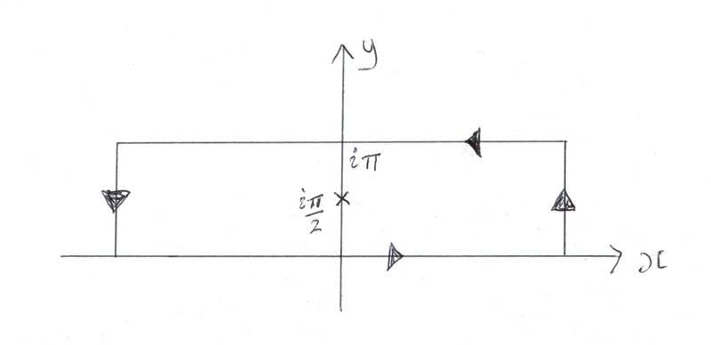

We will evaluate
\begin{align*}
\int_{-\infty}^\infty \dfrac{e^{\alpha x}} {e^x + e^{-x}} dx
\end{align*}
for ##-\frac{1}{2} \leq \alpha \leq \frac{1}{2}## by considering the rectangular contour integral (see figure) of
\begin{align*}
\oint_C \dfrac{e^{\alpha z}} {e^z + e^{-z}} dz
\end{align*}
Hand-drawn contour in the complex plane with x and y axes: a rectangle with horizontal sides on the real axis and on y = iπ, joined by vertical sides, with arrows showing direction, a cross marking iπ/2 on the imaginary axis, and iπ labelled at the top.
The integral along the vertical edges vanishes as:
\begin{align*}
f(z) = \dfrac{e^{\alpha (x+iy)}}{e^{x+iy} + e^{-x-iy}} =
\begin{cases}
e^{(\alpha - 1) (x+iy)} & x \rightarrow \infty \\
e^{(\alpha + 1) (x+iy)} & x \rightarrow - \infty \\
\end{cases}
\end{align*}
So that
\begin{align*}
\oint_C \dfrac{e^{\alpha z}}{e^z + e^{-z}} dz & = \int_{-\infty}^\infty \dfrac{e^{\alpha x}}{e^x + e^{-x}} dx + e^{\alpha \pi i} \int_{-\infty+ i \pi}^{\infty + i \pi} \dfrac{e^{\alpha x}}{e^x + e^{-x}} dx
\nonumber \\
& = (1 + e^{\alpha \pi i}) \int_{-\infty}^\infty \dfrac{e^{\alpha x}} {e^x + e^{-x}} dx
\end{align*}
and so
\begin{align*}
\frac{1}{4} \int_{-\infty}^\infty \dfrac{e^{\alpha x}} {e^x + e^{-x}} dx & = \frac{i \pi}{2(1 + e^{\alpha \pi i}) } \frac{1}{2 \pi i} \oint_C \dfrac{e^{\alpha z}}{e^z + e^{-z}} dz
\nonumber \\
& = \frac{i \pi}{2(1 + e^{\alpha \pi i})} \lim_{z \rightarrow \frac{i \pi}{2}} (z - \frac{i \pi}{2}) \dfrac{e^{\alpha z}}{e^z + e^{-z}}
\nonumber \\
& = \frac{i \pi}{2(1 + e^{\alpha \pi i})} \lim_{z \rightarrow \frac{i \pi}{2}} \dfrac{e^{\alpha z}}{e^z - e^{-z}}
\nonumber \\
& = \frac{\pi}{4(1 + e^{\alpha \pi i})} e^{\alpha \frac{i \pi}{2}}
\nonumber \\
& = \frac{\pi}{8} \frac{1} {\cos (\dfrac{\alpha \pi}{2})} .
\end{align*}
We then have
\begin{align*}
\frac{1}{4} \int_{-\infty}^\infty \dfrac{x^2} {e^x + e^{-x}} dx & = \frac{\pi}{8} \frac{\partial^2}{\partial \alpha^2} \left. \frac{1}{\cos (\dfrac{\alpha \pi}{2})} \right|_{\alpha =0}
\nonumber \\
& = \frac{\pi^2}{16} \frac{\partial}{\partial \alpha} \left. \frac{\sin (\dfrac{\alpha \pi}{2})}{\cos^2 (\dfrac{\alpha \pi}{2})} \right|_{\alpha =0}
\nonumber \\
& = \frac{\pi^3}{32} \left. \frac{\cos^3 (\dfrac{\alpha \pi}{2}) + 2 \sin^2 (\dfrac{\alpha \pi}{2}) \cos (\dfrac{\alpha \pi}{2})}{\cos^4 (\dfrac{\alpha \pi}{2})} \right|_{\alpha =0}
\nonumber \\
& = \frac{\pi^3}{32} .
\end{align*}
So finally,
\begin{align*}
\sum_{n=0}^\infty \dfrac{(-1)^n}{(2n+1)^3} = \frac{\pi^3}{32} .
\end{align*}

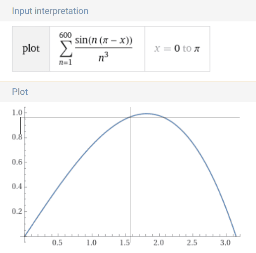

With wolfram.

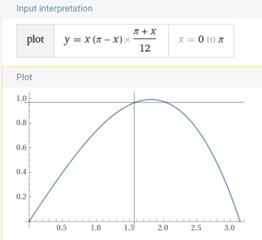

Wolfram Alpha plot of y = x(π − x)(π + x)/12 for x from 0 to π, a downward-opening arch rising to about 1.0 near x = 1.8 and falling to 0 at both ends.
It shows [tex]\frac{\pi^3}{ 32}=0.9674...[/tex]

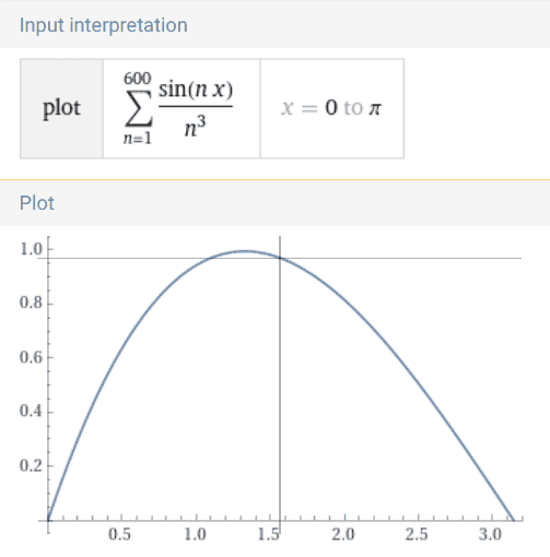

[tex]T_+ (\frac{\pi}{2})=T (\frac{\pi}{2})=1-3^{-3}+5^{-3}-...[/tex] which is confirmed as below shown.
Wolfram Alpha plot of the partial sum of sin(nx)/n^3 for n from 1 to 600, over x from 0 to pi, rising from 0 to about 1.0 near x=1.3 and falling back to 0 at pi.

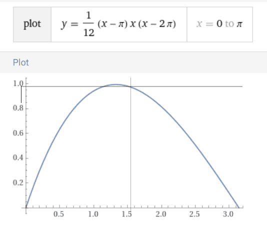

Plot of y = (1/12)(x − π)x(x − 2π) for x from 0 to π, a downward-opening arch rising from 0 to a peak near 1.0 around x = 1.3, then falling back to 0 at x = π.
Where I went wrong ? We may have to choose the basic area for repetition where Y of sin Y for n=1 does not change sign, e.g. ##0 < x < 2\pi## for
