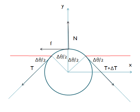

Here's an sketch of what @etotheipi nicely explained at #4.
Notice that if we were to take ##T## as constant (i.e. ##T \neq T(\theta)##) it would imply that the pulley would be frictionless.
$$-T\cos(\Delta \theta/2) -f +T\cos(\Delta \theta/2)=0 \ \Rightarrow \ f=0$$
Nice picture, but that is not what is meant by a "frictionless pulley". That expression is used to mean that the axle is frictionless, i.e. no frictional torque. Generally we assume there is no slipping between the pulley and the rope. This matters when the pulley may be accelerating and the moment of inertia of the pulley may result in a change in tension.
Oh, and to be even more pedantic, T=T(θ) doesn't rule out the constant case.
Thanks flor the comment haruspex but I am afraid I do not follow your argument. Doesn't 'no frictional torque' mean ##f=0##, as I suggested?

I think you are both right, but just talking about slightly different things? There can be friction acting at the axle which exerts a resistive couple on the pulley, and there can also be friction at the pulley-rope interface which can likewise exert a torque on the pulley.
N.B. that since the string is massless, the net force on any small piece must still be exactly zero even if the pulley is accelerating, so the same analysis holds as for the static case.
