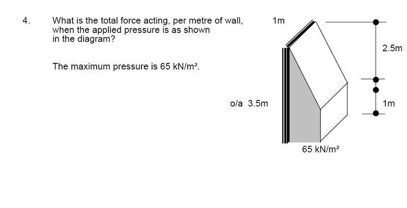

What is the total force acting per metre of wall when the applied pressure is as sho
What is the total force acting per metre of wall when the applied pressure is as shown in the diagram? The maximum pressure is 65 kN/m2
  • Diagram of a retaining wall with a trapezoidal pressure distribution, labelled 1m at the top, 2.5m, 1m and o/a 3.5m, with maximum pressure 65 kN/m² at the base; text question 4 beside it.
