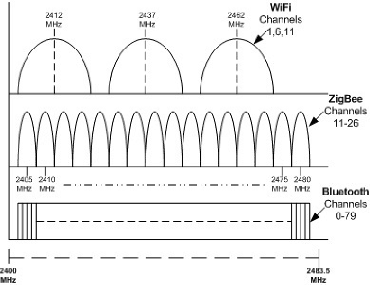

The channel spacing is not just based on any potential Doppler shift of the center frequency of each channel. It is also based on the bandwidth of the communication. You can't have 20kHz wide channels spaced only 300Hz apart. The overlapping frequencies would ruin communication.
So start with the bandwidth of the information in each channel (is that given? something like 20kHz voice?), plus some guard bands for the bandpass filters to roll off enough to keep down the cross-channel interference.
You can see an example by looking at how the WiFi and ZigBee channels in the 2.4GHz band are spaced. Look at the channel width (which is based on the data speed needed for each channel), plus some guard band spacing between the channels.
Does the problem tell you what each channel's information bandwidth is plus the required guardbands?
https://www.researchgate.net/publication/327174774/figure/fig1/AS:664591931539457@1535462472996/Channel-distribution-of-different-technologies-in-24GHz-frequency-band.png
