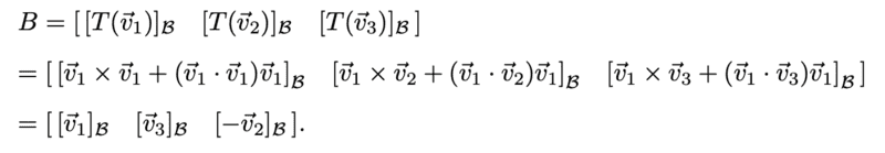

Let B = (v⃗1, v⃗2, v⃗3) be any basis of R3 consisting of perpendicular unit vectors, such that v⃗3 = v⃗1 × v⃗2. Let T(x⃗) = v⃗1 × x⃗ + (v⃗1 · x⃗)v⃗1. Find the B-matrix B of the given linear transformation T from R3 to R3. Interpret T geometrically.

Could anyone explain the reasoning from step 2 to step 3?
Specifically, I don't understand how to find the product of a cross product and a vector - like (v1 · v2)v1 and (v1 · v3)v1. I'm also confused by v1 × v3 + (v1 · v3)v1 -- is v1 × v3 = v1v3? How would this be added to (v1 · v3)v1?
Thank you.
There is no cross product and a vector. There is a dot product and a vector. The dot product is just a scalar multiplying the vector.
The vectors are orthonormal so ##\vec v_1\cdot \vec v_3=0##. The expression therefore reduces to ##\vec v_1\times\vec v_3##.
For the second transformation, v1 x v2 = v3, but what does (v1 · v2)v1 equal?
Why would ##\vec v_1\times\vec v_3## = ##-\vec v_2##?
Thanks.
What is ##\vec v_1\cdot \vec v_2## if all ##\vec v_i## are orthonormal?
jolly_math said:
Why would v→1×v→3 = −v→2?
Because you know that the ##\vec v_i## form an orthonormal basis and that ##\vec v_1\times\vec v_2=\vec v_3##.
The dot product would be zero, I understand the second transformation now.
I don't have much experience with cross products, does ##\vec v_1\times\vec v_2=\vec v_3## directly lead to ##\vec v_1\times\vec v_3 = -\vec v_2##?
Together with the fact that the ##\vec v_i## are orthonormal, yes.
It makes sense now, thank you!
