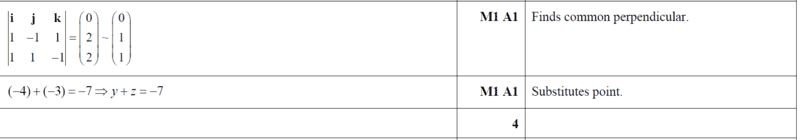

The solution is here;
Now to my comments,
From literature, the cross product of two vectors results into a vector in the same dimension. A pointer to me as i did not know the first step. With that in mind and using cross product, i have
##(1-1)i - (-1-1)j+(1+1)k =0i+2j +2k## as shown in ms attachment.

The general form of the equation for a plane is
\vec n \cdot \vec r = C,
where ##C## is a constant and ##\vec n## is normal to the plane. You have first found ##\vec n## so that is fine, but after that you are inserting the general form of any parametrised point on the plane. This is unnecessarily complicated. You know that the expression above should equal the same constant ##C## regardless of the point so using a single point in the plane will give you ##C##. The easiest is to just take the point corresponding to ##\mu =\lambda = 0##, i.e., ##\vec r = -4\hat j - 3\hat k##. Doing so with ##\vec n = \hat j + \hat k## results in
C = -4 \cdot 1 - 3 \cdot 1 = -7
and therefore
\vec n \cdot \vec r = y + z = -7
Also note that there is no requirement that ##\mu + \lambda = 0##, but this just describes a line in the plane. The values of ##\mu## and ##\lambda## are arbitrary, but the point is that you will get the same constant ##C## regardless of the values of ##\mu## and ##\lambda##.

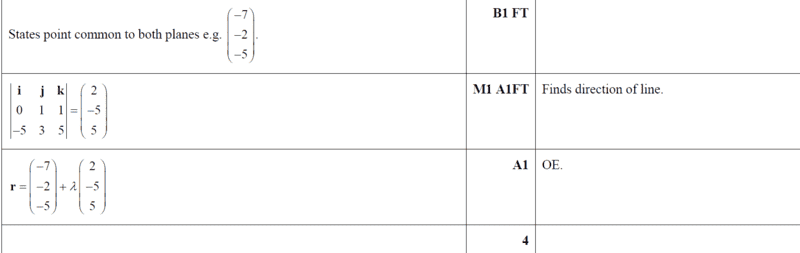

This is also related part of question,
The solution is here - quite clear to me
but nothing wrong with me having,
##y+z-7=0##
##-5x+3y+5z-4=0##
setting ##x=0## gives
##y=-\dfrac{39}{2}## and ##z=\dfrac{25}{2}##
Thus,
##r+λ(n_1 ×n_2) = (0, -19.5, 12.5) +λ(2,-5,5)##
Sure, it is just a different parametrisation. Setting ##\lambda = \lambda' - 7/2## should give you the parametrisation given in the answer key.
