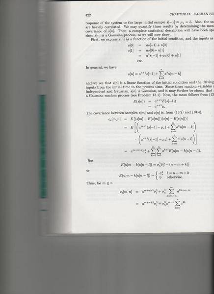

I'm not sure what you mean here : ( I'm sorry, but I really am trying... I have to admit, the equation I supplied is modified from the original shown in the book. I will attach a copy of what I am struggling with maybe it will be better. Here it is (I understand everything until where it says "Thus for m ≥ n"):

The correct analogy to what is given in the text is the statement "[itex]x(k,l) = 0[/itex] except when [itex]l = n - m + k[/itex] " (which is different than asserting " [itex]l = n - m + k[/itex] ").
Then [itex]\sum_{l=0}^n x(k,l)[/itex] has only one nonzero term, which is [itex]x(k,n-m+k)[/itex].
Perhaps there is also information in the text that [itex]x(k,n-m+k)[/itex] is zero for [itex]k < n-m[/itex], but I'd have to think about it further to see why.

I think I may have understood how they achieved the second to last line. So we know ##l = n - m + k## (else the equation will be zero). And we also know from the second summation that ## 0 ≤ l ≤ n ##. So I did the following to kind of see what was going on:
for ##l = 0, l = 0 = n-m+k => k = m-n## this will make the first summation to be ##\sum\limits_{k=m-n}^m x(k,n-m+k)##
for ##l = n, l = n = n-m+k => k = m## this will make the first summation to be ##\sum\limits_{k=m}^m x(k,n-m+k)##
for ##l = n-1, l = n-1 = n-m+k => k = m-1## this will make the first summation to be ##\sum\limits_{k=m-1}^m x(k,n-m+k)##
So after viewing these summations, I see it is for ##l =0## in which the first summation takes into account all possible values (or has the greatest summation intervals).
What do you think of this?
EDIT1: I think the last line is achieved from the one before by using the fact that ##\sum\limits_{k=0}^m x(k) = \sum\limits_{k=0+n}^{m+n} x(k-n)##
EDIT2: My first edit (EDIT1) may be wrong. I am still checking.
