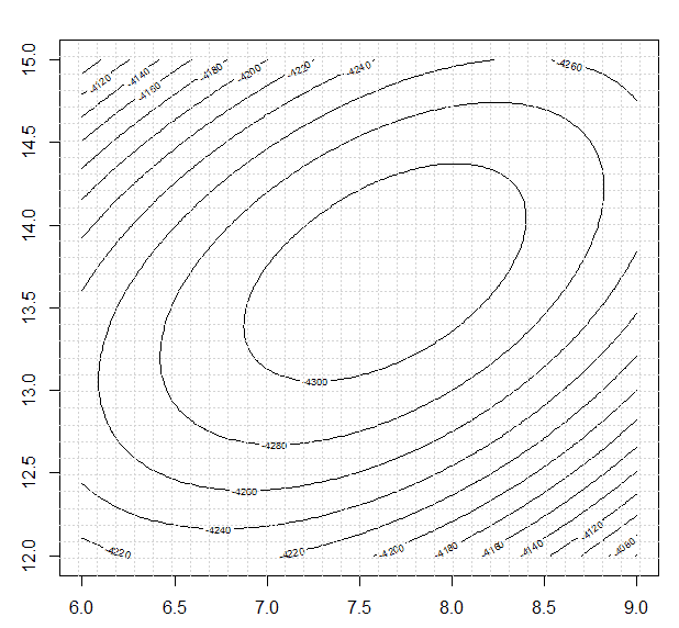

I realised we can use the last formula above directly in a non-linear optimiser to find a result.
I used the R package nlm, with the following code:
[CODE title="R code to optimise selection of input blocks"]library(nlm)
# input parameters ----------
M <- 3 # number of different input shapes
N <- 20 # number of different output shapes
# parameters for output shapes
v0 <- 0
u0 <- 1
v1 <- u1 <- 1
# express guess as increments of index, not as absolute indices.
startguess <- c(10, 6)
if (any(startguess < 0) | sum(startguess) >= N)
stop('capt says startguess is not valid')
# wastage function ---------
wastage <- function(avec){
# avec is a vector of length M-1, with avec[k] = a_k
x <- cumsum(avec)
a <- c(0, x)
a1 <- c(x, N)
if (any(avec < 0) | any(x >= N) )
# input outside of constraints, so return huge wastage value to disqualify this input
return(10^8) else
# calc the wastage properly
return( sum((a1 - a - 1) * ( (u0 + u1 * a1)^2 - (v0 + v1 * (a + 1) )^2 ) ) )
# perform nonlinear optimisation
x <- nlm(f = wastage, p = startguess )
# print results
print(x)[/CODE]
This has N=20 output shapes, having inner and outer diameters of 1, 2, ..., 20 and 2, 3, ..., 21 respectively, and allows M = 3 different input shapes. Following my logic above, I assumed the diameter increments between input shapes should reduce for larger shapes, and so guessed indices of 10, 16, 20. We ignore the 20 because that always has to be the biggest index, so that leaves our guess as 10, 16. For the program we express these as increments rather than absolute indices, so the starting guess for the optimiser (variable 'startguess') has two elements: 10 = 10 - 0 and 6 = 16 - 10.
It gave the following output:
[CODE title="Optimiser results"]$minimum
[1] 2311.83
$estimate
[1] 8.935301 6.015709
$gradient
[1] -1.763963e-04 -1.776443e-05
$code
[1] 1
$iterations
[1] 8[/CODE]
The result is in $estimate and to the nearest integer is 9 and 6, which gives indices of 9, 15, 20. So our initial guess of 10, 16, 20 was not bad.
I haven't tried it but the code should work for any valid combination of N, M, u0, u1, v0, v1.

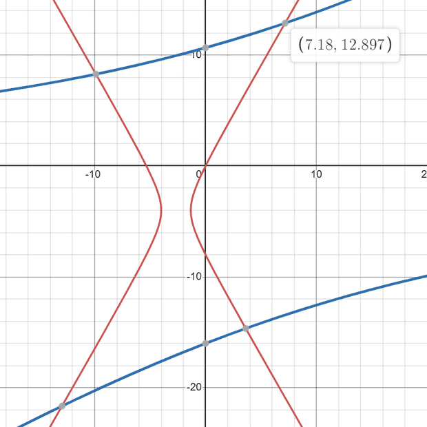

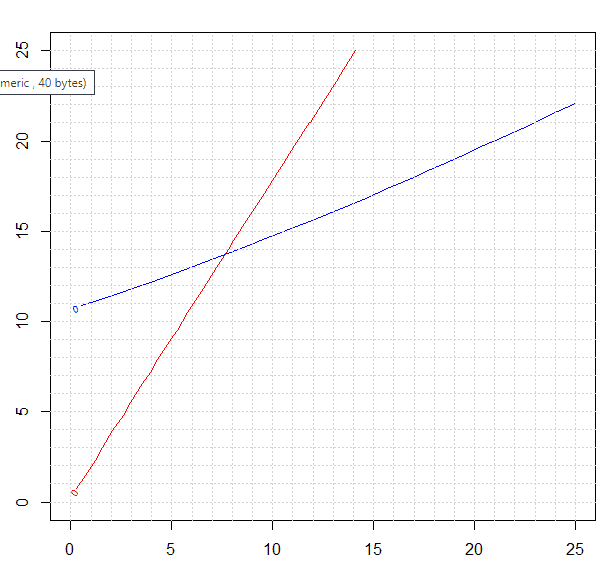

First of all, thank you so much @andrewkirk for taking your time to study this "obsession" of mine.
I'd like to update this thread with some further research I've done lately, in case anyone is curious about it.
I'm analyzing a simpler case, for which I can get a correct solution when ##M=2## but not when ##M=3## (or greater).Introduction
In order to get some insights about this optimization problem, I've been analyzing a "much simpler" case: instead of finished rings machined from raw tubes, I considered finished rods machined from raw solid (round) bars. Thus, the machining now consists in "peeling off" material from the raw bar to get the finished diameter of the rod (in other words, it's about reducing the raw bar diameter and considering the scrap material formed during this operation).
So, I want to machine rods with ##N## different diameters ##D##:
$$ D_1, D_2, ..., D_i, ..., D_N $$
I don't want to purchase raw bars with ##N## different diameters (one for each of the finished rods), but I want to restrict the number of raw sizes to ##M## (with ##M<N##), and they will be used for machining all the ##N## finished rods.

I think a viable solution would be to plot the curves of the two implicit equations in a "##j##-##k## diagram" and check for the intersection point where both ##j## and ##k## are positive.Specific example with ##M=3##
Again, let's suppose my ##N=19## finished diameters are:
$$D_i = 5,6,7,8,9,10,11,12,13,14,15,16,17,18,19,20,21,22,23$$
Again, I have the exact equality ##D_i=g(i)=i^2+8i+16##.
If I plot (courtesy of Desmos.com) the the two implicit equations that I get following the procedure above, I get the following graph:
So, apparently, ##j \approx 7## and ##k \approx 13## are the solutions.
The correct solution that minimizes the amount of scrap material, calculated by brute force, is instead ##j=8## and ##k=14##. Close enough but not the same.

Were was the mistake in the approach used for ##M=3##?
As already said, I guess the formulation of the problem does not correctly take into account the requirement ##j<k##. However, the theoretical (wrong) solution respects this requirement.
Also, for the optimization problems I'm used to study (polynomial regression), I always am in the situation where taking partial derivatives and setting them equal to zero is legit. Is it legit here?

Your formulas look correct, excluding the typo in the one containing ##\Delta_0##.
I think the error lies in your solving of the equations. Perhaps you coded something incorrectly.
When I solve for the intersection of the two curving lines I get j = 7.65, k = 13.72. The nearest grid point to that is (8, 14), which matches your brute force solution.

# have a look at the scrap matrix near the expected optimal point
j = 6:9
k = 12:15
x <- outer(j, k, S)
dimnames(x) = list(j = j, k = k)
print(x)
# have another look, more zoomed in
j0 = 7.65
k0 = 13.72
j = j0 + 0.01 * seq(-2, 2)
k = k0 + 0.01 * seq(-2, 2)
x <- outer(j, k, S)
print(x)
# Generate data for a 3D plot
j <- seq(6, 9, length.out = 150)
k <- seq(12, 15, length.out = 150)
s <- outer(j, k, S)
# Create a 3D plot
persp(j, k, s, theta = 30, phi = 30, expand = 0.5, col = "lightblue") ###########################
# Now create a contour plot
dev.new()
contour(j, k, s) ###########################

# Now plot the lines where partial derivatives are zero
dev.new()
j1 <- k1 <- seq(0, 25, length.out = 20)
Sj <- function(j, k)
  2 * alpha1 * j + 3 * alpha2 * j^2 - k * alpha1 - k^2 * alpha2
Sk <- function(j, k)
  2 * alpha1 * k + 3 * alpha2 * k^2 - j * alpha1 - 2 * k * j * alpha2 + alpha0 - DNsq
sk <- outer(j1, k1, Sk)
# draw first line
contour(j1, k1, sk, level = 0, col = 'blue')
sj <- outer(j1, k1, Sj)
grid(nx = 27) ###########################
# draw 2nd line
contour(j1, k1, sj, level = 0, add = T, col = 'red')
Here are scrap values at integer grid points near the solution. Note that (8, 14) is best.
Code:
   k
j      12    13    14    15
  6 -4212 -4254 -4214 -4086
  7 -4221 -4296 -4291 -4200
  8 -4172 -4280 -4310 -4256
  9 -4059 -4200 -4265 -4248
Here are scrap values zoomed in near the intersection point:
Code:
   k
j           13.7     13.71     13.72     13.73     13.74
  7.63 -4313.620 -4313.624 -4313.620 -4313.607 -4313.586
  7.64 -4313.622 -4313.630 -4313.629 -4313.620 -4313.603
  7.65 -4313.618 -4313.630 -4313.633 -4313.627 -4313.614
  7.66 -4313.609 -4313.623 -4313.630 -4313.628 -4313.618
  7.67 -4313.592 -4313.611 -4313.621 -4313.623 -4313.616
Here is a contour graph of the scrap function:

Dear @andrewkirk , thanks a lot. I'll double check everything later.
I've checked and I think I had Indeed written something wrong into Desmos, the equations are correct.
Again, thank you @andrewkirk for you super valuable review
