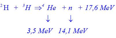

I am not talking about the reactions of simple atoms in chemistry, I am speaking, for example deuterium, heavy water, isotopes of hydrogen, oxygen, carbon, etc.I would like to know how to calculate when two atoms merge, to know mathematically what atom will form, example deuterium + deuterium = helium
Can someone explain me the calculations? I'm new to the forum, please!
